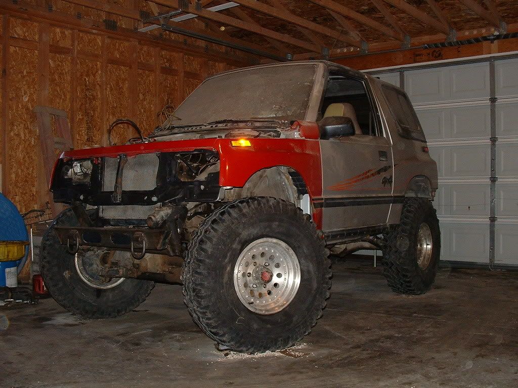

Offline Chief
  • 678
  • Whaddya lookin at??
Re: Need toyota axle suggestions
« Reply #6 on: February 28, 2008, 06:32:19 PM »
I plan on running yota axles also. 84-85 years are the stoutests, they have alot of extra gusseting from the factory. I would run at least 35's on em. And fer gawds sake, don't get thornturds!!
I think an exo should be minimalistic. Build a stinger, run a bar from about the height the headlights back to a bar going up and over the top of the windshield, and a bar going over the cowl. Bar over the B pillar, and connect the 2. Make the back simple too keep the weight down. Build some stout sliders to run the exo off of also.
Post pics!
03 Tacoma, BBP sliders, TRD L/S, Modded intake,  Da Tow Bitch
94 Tracker. Cancer mod :p Otherwise stock
