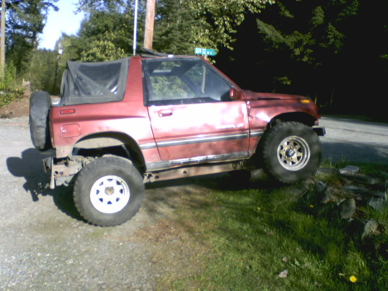

Hi all, i love the website already have gotten a ton of information neccessary to facilitate repairs on my tracker.
Here is a few pix.
pics are without the coil spring spacer
Some stats
1993 geo tracker lsi, 3" body lift, some minor fender trimming, 31" tires, 1" coil spring spacer, 1991 toyota mr2 100amp alternator(pretty easy to install, pm if you want to know how, i might get around to doing a write up on it if demand is enough) soon to have a volvo td05-12b turbo on it.
