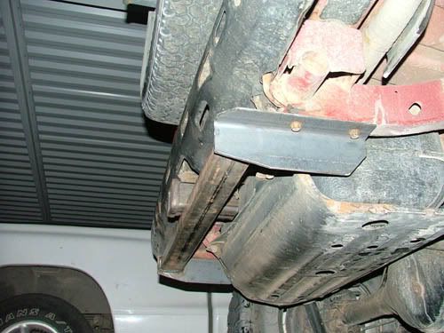

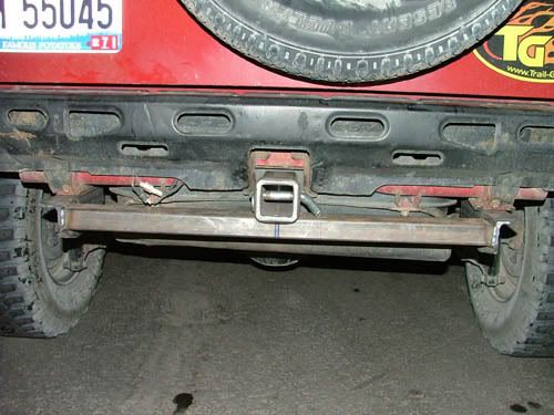

Well I sold my old trailer hitch off of the little Geo, so it was time to build a new one. I used 2" x 3" - 3/16" thick angle for the end pieces that bolt up to the frame. I honestly can't remember the dimensions on the cross bar though. I did cap it all off with a 6" long receiver tube. I still need to do the final welding of the receiver tube as well as adding the loops for the safety chains.

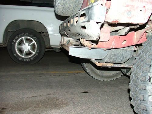

I should have measured things before, but I would guess that I've gained about 6" to 7" of clearance under the hitch. I is also tucked in next to the body as much as I could.  I had to cut out a little section in the center of the bumper bar.  I also trimmed the lower portion of the bumper bracket that is welded to the round cross member.  With the spacing of the holes in the bumper bar it almost looks like it was ment to be done this way.
I'll get it welded up and then use some tubing to make gussets for where the bar attaches to the angle iron. I'll also make a couple of gussets for the reciever tube as well.

That's super clean looking. I like how you put the 2" reciever on top so it doesn't get dragged on the ground every time you hit the trails.

Looks great.   Think I'll do mine that way.  Only question--the four bolts holding it on look small.  Is their shear strength adequate?  When I built one for my '85 Toyota I used channel where you have the angle and ran a vertical piece from it to the side of the frame, with a couple more bolts through the frame.  Might have been overkill.

I would say yes, but I would also qualify that by telling you to stay within a class 2 tow rating.  I would have to look that up in my trailer supplies catalog at work to get the specific pound rating though.  For recovery work on harder trails I would look into adding at least a couple more attachment points.

That looks good. In the UK all towbars/hitches fitted to vehicles after a certain year have to be certified. On my towbar there is a third bolt on each side, it goes up through the frame and above the frame there is a thick plate with a nut welded to it. The issue may be the strength of the frame rather than the shear rating of the bolts.
