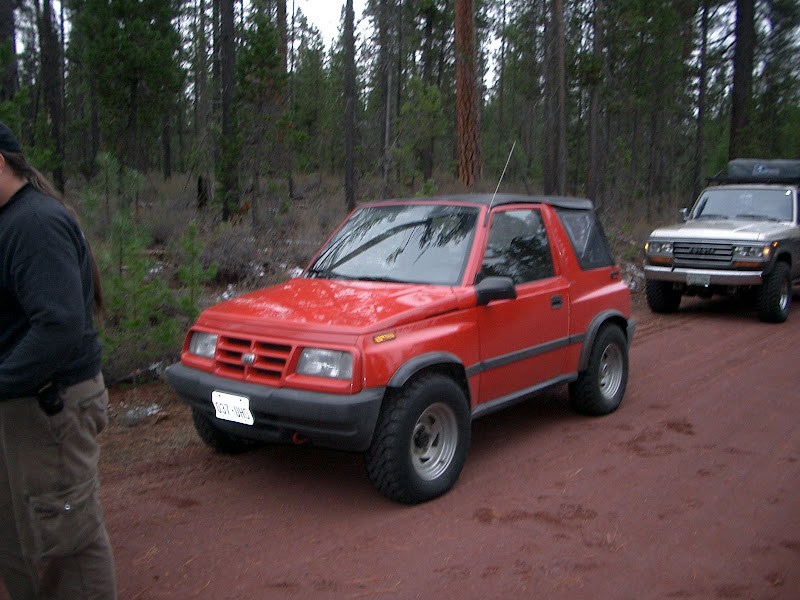

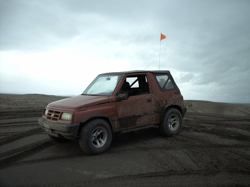

Tracker, Sidekicks and SunRunners are all the same vehicle.  Here are some pictures of my 2 door.
Using Jeff's 3/4" spacer in front and a 1" spacer in the rear with Toyo 235/75 R15 All Terrain tires and 1" wheel spacers.  I recently switched to Grand Vit coils up front for a smoother ride and need to swap my rear shocks from the Grand Vit ones back to stock Tracker as they are just to stiff for a daily driver vehicle.   If I had to do it all again I would have just spent the money on an OME 1.5" lift or Calmini 2".
Stock with some Wild Country Mud Terrain tires.  We ended up poking holes in sidewall on both the rear tires and had to drive out with plugs in them.  I don't recommend these tires for much of anything.  They do look nice though.
