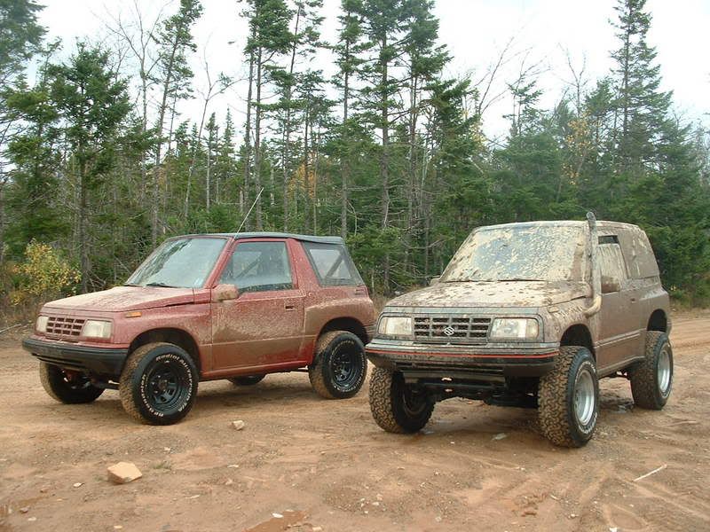

And another update:
He found and bought some used 31-10.5-15 Thursday...
And we went out on Sunday...

looks great, how are the tires working, any rubbing?
It rocked all day, he only got stuck once, got hung up on a big rock in a water hole, he was teatering on it, and needed a tug. The tires he bought are almost new, the PO didn't like them, he found them noisy.  :P
Not this one, but just another action shot ;)
