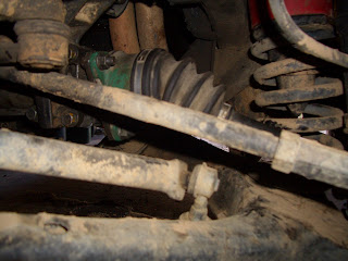

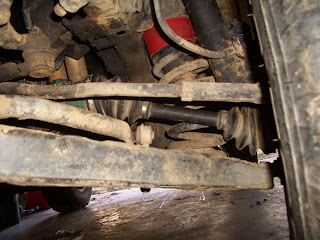

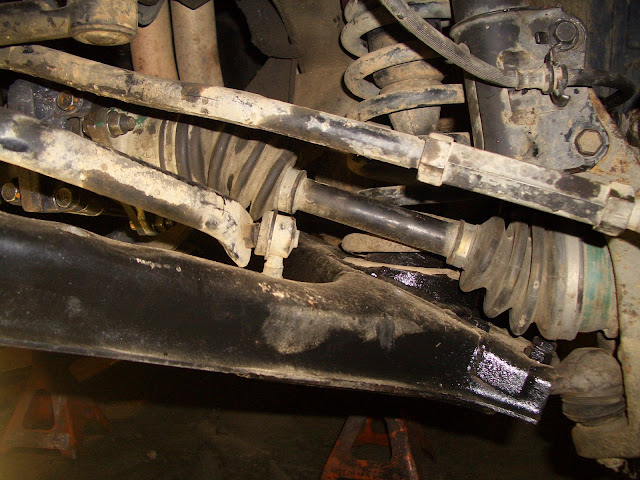

I was running a 2" spring spacer, and 4 door springs (in a 2 door), and blew out a CV on the first outing.  I dropped the diff. 1 1/2" and raised the outside edge of the spring pad 1".  I also cut the spring spacer down to 3/4" and have about the same ride height.  My CV angles are great at full drop (2" strut spacers).  I still have a slight bow in springs, so 1 1/2" would not seem out of the question.
Bowed spring (before mod.)                                         CV angle at full drop  (before mod.)
Current CV angle at full extension
The ride has also improved.  Full description on DIY of my Tracker build.
