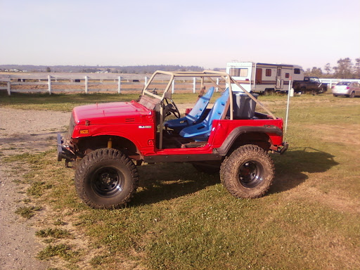

I just bolted some angle iron on the side.  Works great for me.  :D

Oh yea, I've dropped it on all sorts of stuff.  Never even budged.  For proof check out the video:
http://www.youtube.com/Drone637#p/a/u/0/SaVr8eofYrU
I have 4 holes drilled through the body with some 3/16th on the back side to make sure that I have plenty of strength on the mounts to keep the bolts from pulling through the body.  The front two go into the cab, the back two go just underneath it.  There is room for a 5th bolt if you want to put it on there but I haven't found it necessary.
This does not allow for the use of an added bar to help keep the vehicle off of trees and the like, and I wouldn't recommend welding a bar onto this sort of configuration due to the extra leverage on the body.  If you want the bar I would still use the angle but come off of your frame as well.

I'd say the the angle iron works?

anther for just angle iron mine is held on by 6 self tappers hasn't budged at all either hit some rock pretty hard too.

Nice rig.
