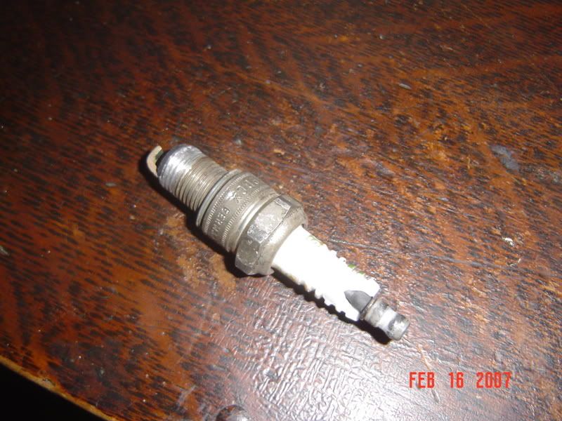

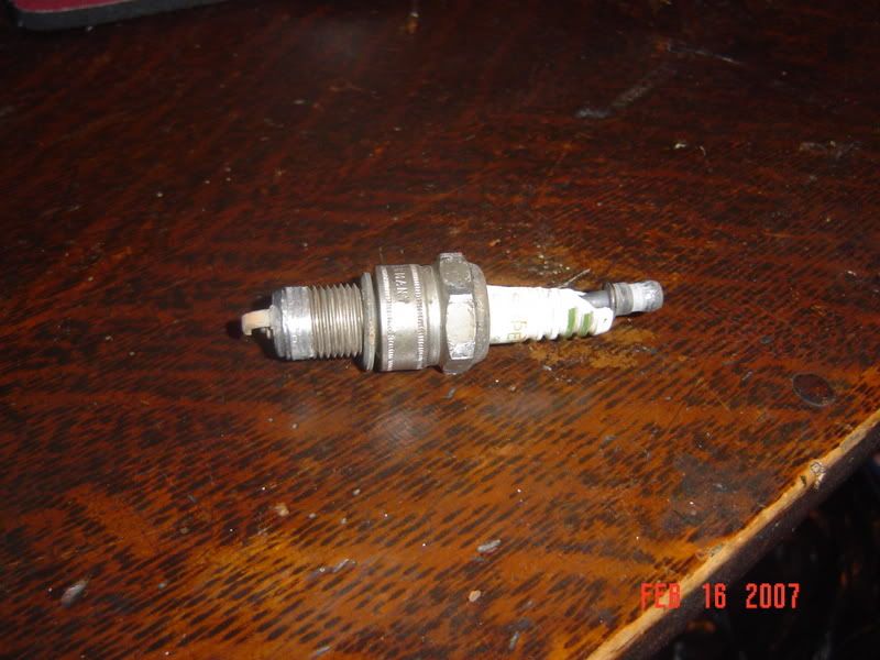

Here are a couple pics of the really bad plug:
Funny thing is that the plug actually looks like a clean burn.. no foulling..
