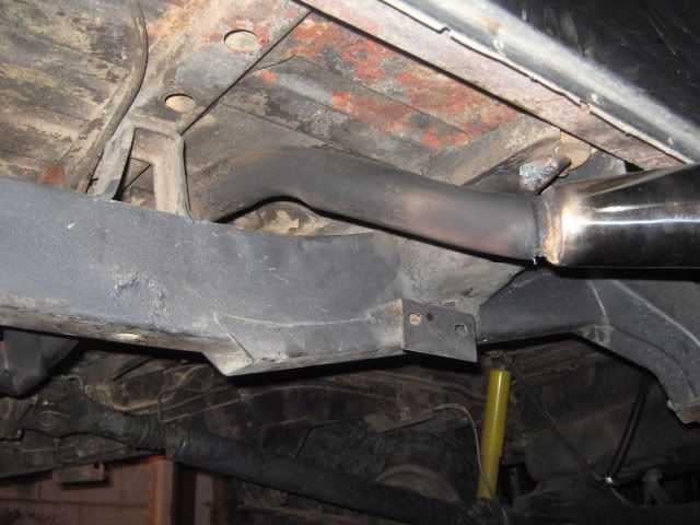

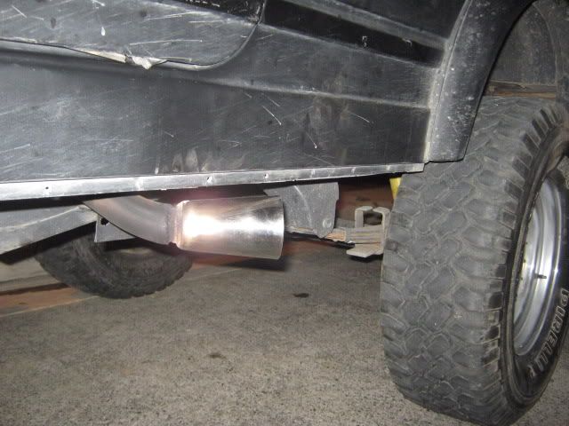

bonestock sammi right? the 1300cc carb engine?
waht I did is remove the cat and install a new one, and changed the whole exhaust as well. you can do a side-exhaust with at least an 18-24" resonator, 2" 1.75 or 2 diameter, and stick it out on the left side, almost at front of the rear left tire. make sure that they are mandrel-bent, not crush-bent.
I just used a galvanized reso and welded pipings.
in my opinion, change everything at once instead of troubleshooting- It might come out cheaper than doing trials.
here's what we did on my sammi before I swapped engines.
to avoid scraping the pipes during trails and treks, I made it go through the body and chassis.
sticks out just after the door. note that it's a LWB  so on a SWB it might be nearer the rear left tire.
hope this helps
