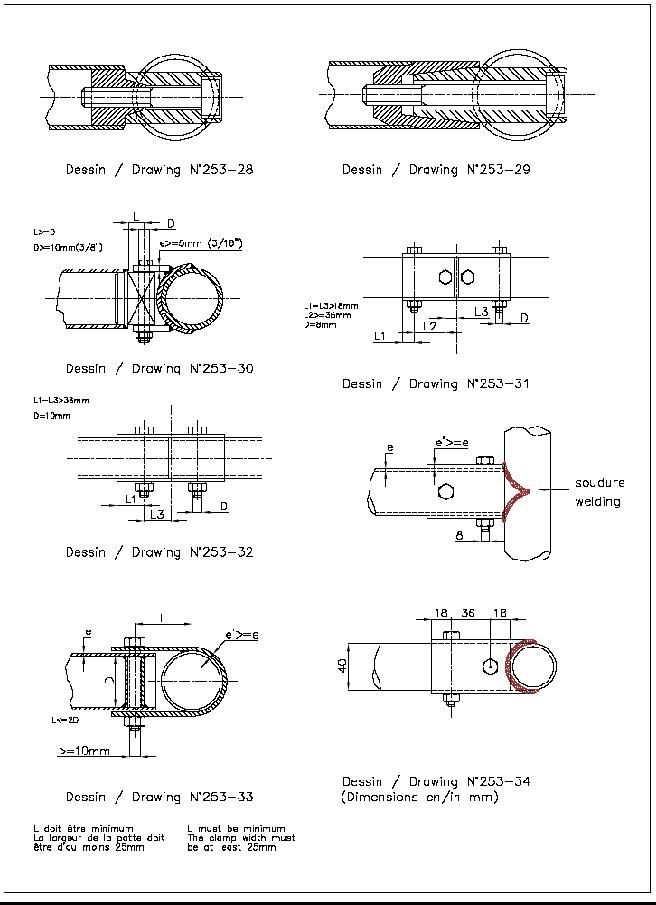

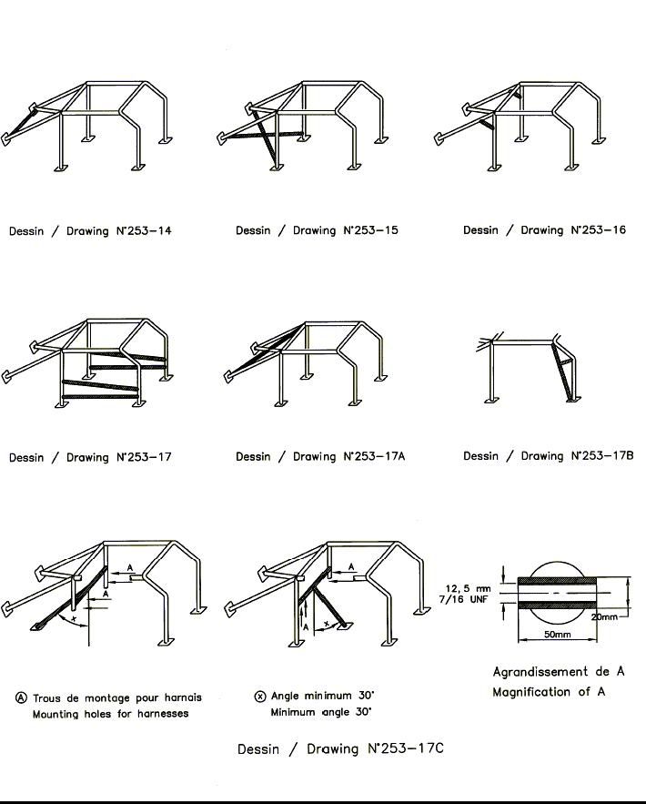

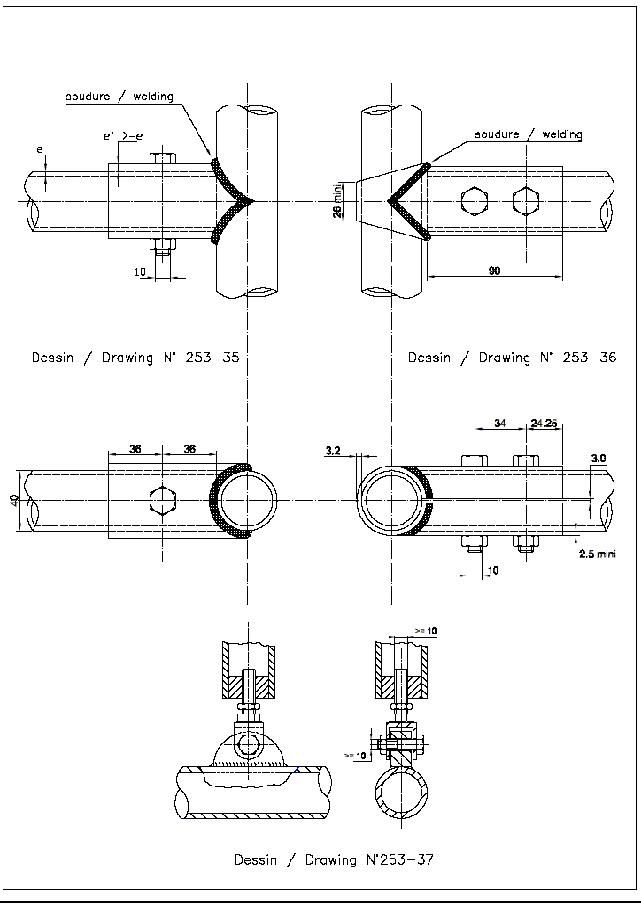

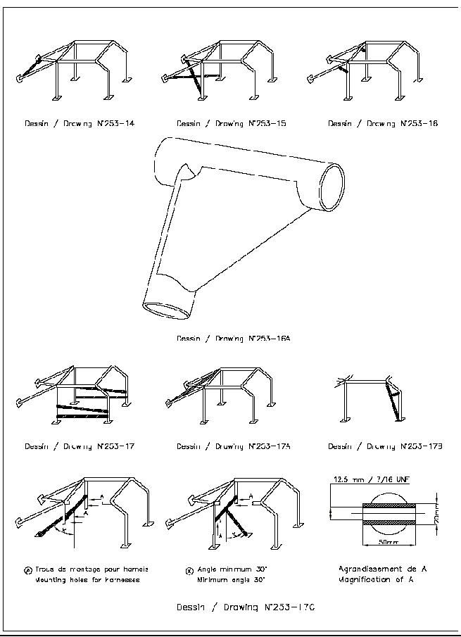

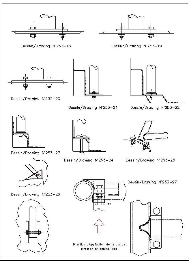

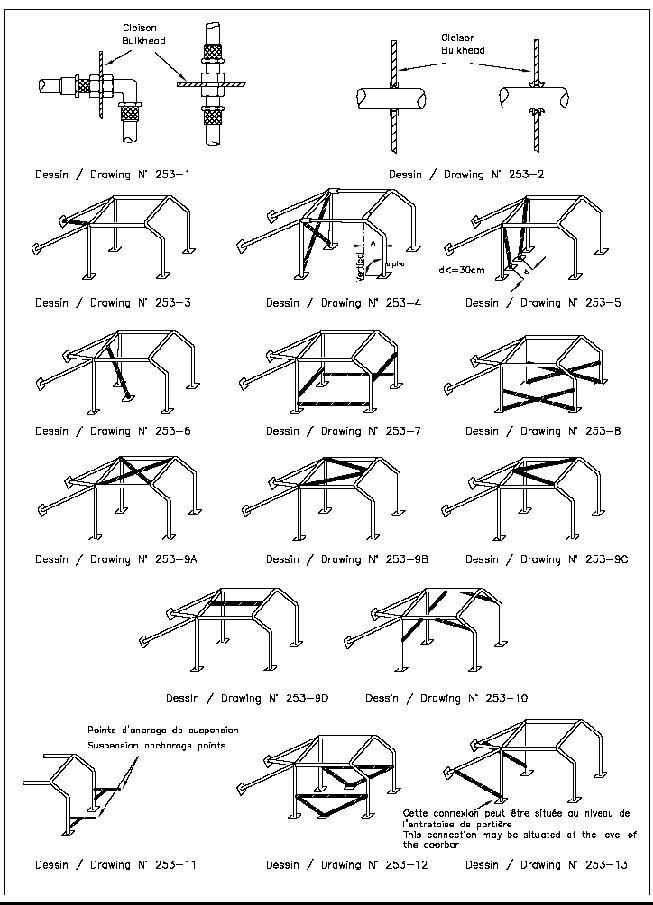

I looked in the rool book for the national Baja competition here in Chile and found some of the FIA homologated rollcage designs off course the size of the tubing , wall thikness and many other stuff are to tedious to read so I just took the schematics.
Hope it helps you
