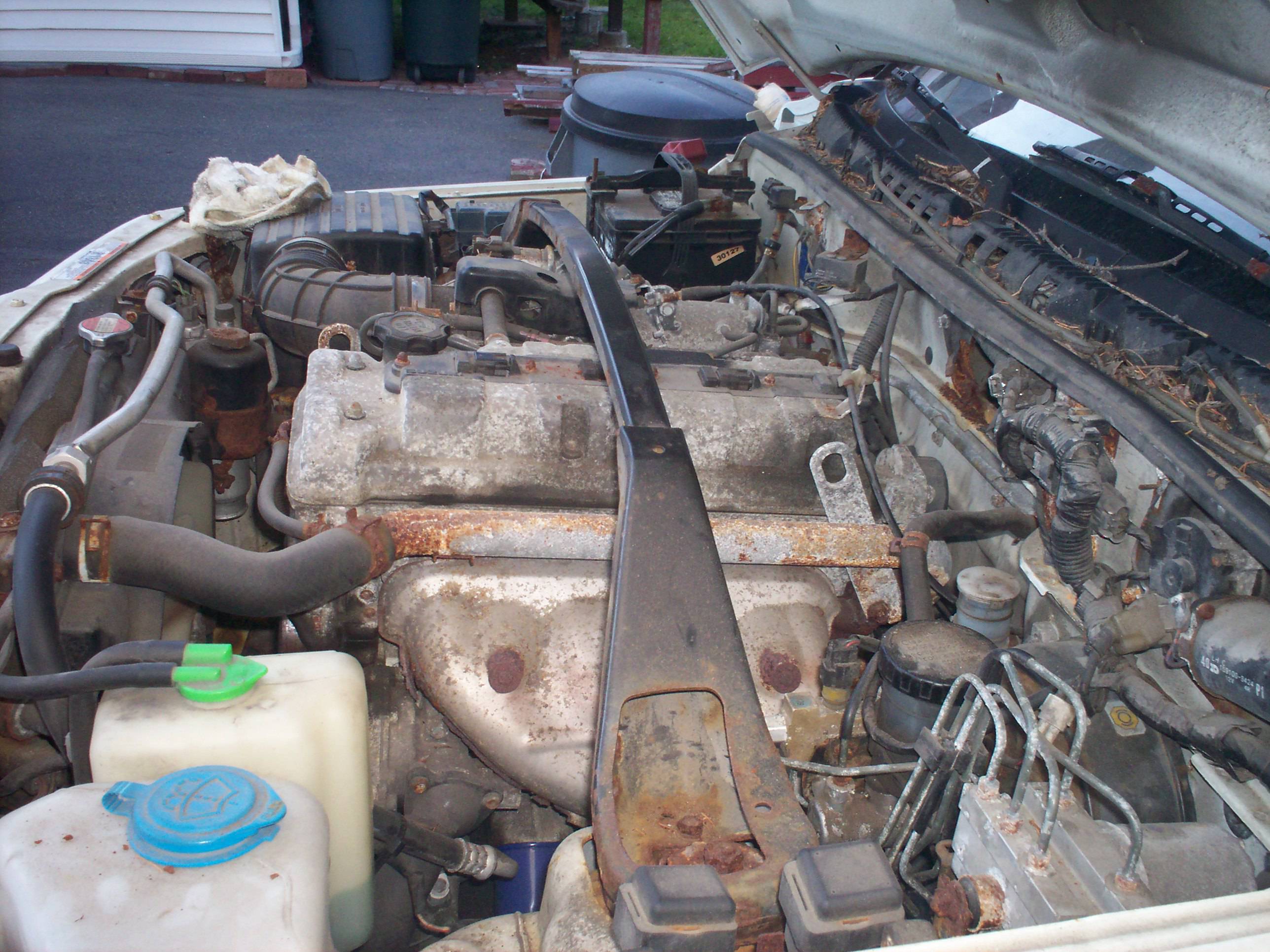

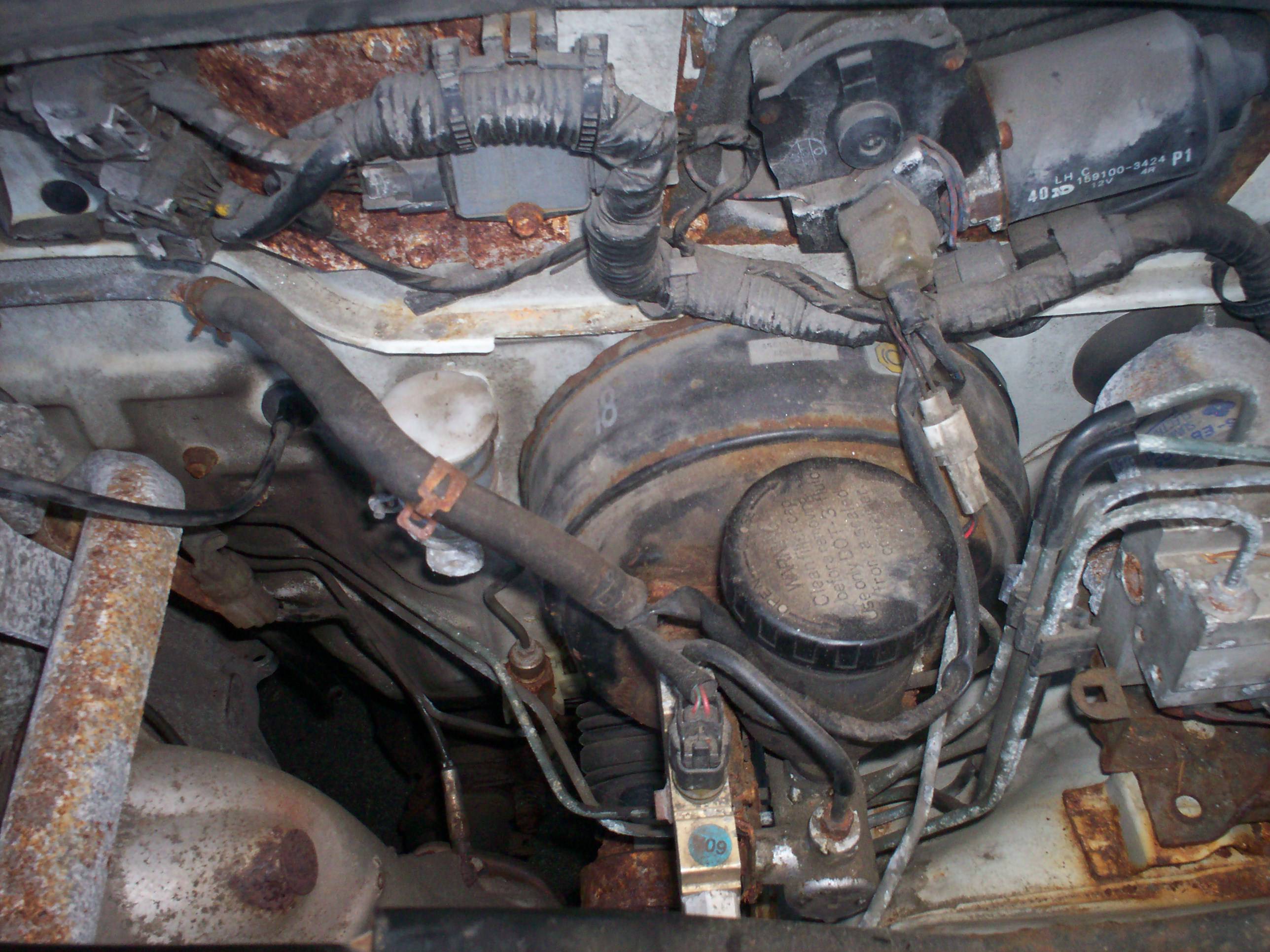

i'm new to this forum in hope of search for repair/mantain techniques for my 96 4dr sidekick 5spd manual sports.  i recently got this car from a friend and i was told that the clutch cable is disengaged from the transmission.  there's no pressure against the pedal or whatsoever whenever i depress the clutch.  once its fully depressed it won't bounce back.  so i decided to repllace the clutch cable, but i can't seem to locate such a cable in/out side of the firewall.  any help would be greatly appreciated.  thanks. :)

please note that the clutch cable on my sidekick is not placed like the one in the picture.  the cable on that picture is not existent on my sidekick.
