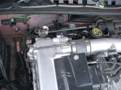

Lastly and the reason why I call this thread wiring from hell, is because this guy also f*cked with the wiring like you wouldn't believe, probably to see if there where any shorts anywhere causing these problems, since replacing the oxygen sensors didnt solve the problem like he thought it would. He obviously didn't do any research before attempting to tackle these codes.
So here are some pics of the wiring from hell.. the guy obviously unravled all the wiring harnesses, and he taped together some relay (red arrow in picture) and also wrapped tape all around some white plug (green arrow) that also has a few random wires taped into the mess that arent attached to anything! so what is this relay and what is this white plug that isn't attached to anything if anyone knows?

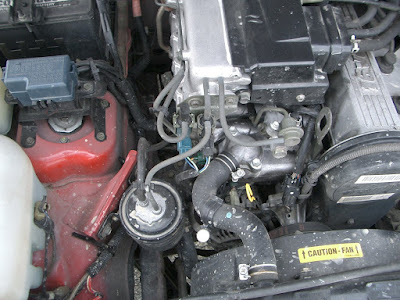

And here is a picture of two little relay lookin things over on the battery side of the engine, the one on the left has a blue/black wire going into it (red arrow), anyone know what it is? or is that the main relay? If it is I thought it would've been a bit bigger or something..

Under your hood should be a vacuum diagram showing how the system works.  There are two electric operated relays on the front of your engine.  The left one is the one that opens up and allows your EGR valve to open and close properly.  I forget if it's closed by default or open to allow vacuum through.
There is a line coming from your intake into that.  Then from there it runs into a vacuum operated relay.  The vacuum operated relay opens up and allows a larger amount of vacuum to open your EGR valve.  To test that the vacuum relay thing is working, disconnect the line going into the left electrical relay on the front of your engine while it is running, then breath in on the tube as hard as possible while checking the back of the EGR valve.  It should automatically pull itself in.
To test the vacuum solenoid on the front of the engine itself just disconnect the tube running to the vacuum relay on the back of the engine and see if you can pull air through it via breathing in on the tube.  Then hit it with 12V, you should have the opposite effect.  I can't remember if it's 12v on or 12v off, but it should change.  The computer will switch it automatically when the engine warms up.
As for the EGR unit itself, that isn't what plugs up.  It is the tube connecting it to your head.  You also need to use a wire to break the carbon loose up inside the head where the tube connects.  Then squirt a bunch of cleaner up there.
Here are some pictures:
Full Size Pic Here
You can see the two tubes going into the left electrical relay.  One comes from the intake, the other goes to the vacuum based relay thing.  If you simply bypass this relay your EGR should open and close with your engine RPM regardless of operating temperature.
Full size Pic Here
The black circle thing with the silver label in the top center is what I refer to as the vacuum relay.  Not sure what it's really called, but the label under the hood gives the correct name.  Basically it opens up with a light vacuum, then allows a stronger vacuum to open up the EGR valve.  You can use a vacuum pump or just disconnect the line running out of it and give a good pull of breath in order to manually kick it into action.

OK still havn't had much time to look at things real closely but when I unplug (cutting 12v power) the solenoid that Drone637 was talking about (green arrow), the egr valve moves! even at the slightest touch of the throttle. I'm assuming the ecu controls this but how does it know when??? There must be something that happens first which tells the ecu to cut the power to that solenoid allow the egr to open at the right time, otherwise with it being unplugged it works ...but even right at start up with a completely cold engine, and still gives me the p0400 code.
