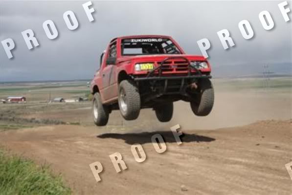

My Zukiworld Challenge car will be used for just that. It is not street legal but could be very easily.
FYI I am not trying to steal this image, just have not ordered it yet... ;D
