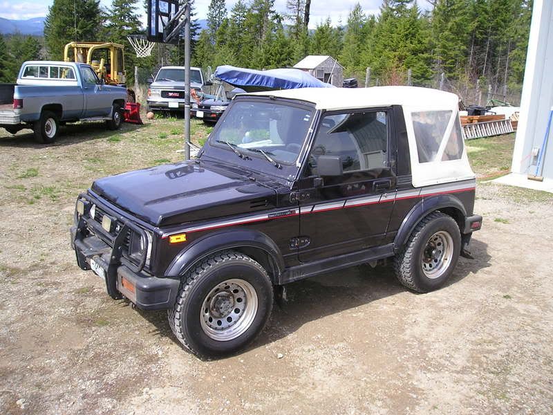

FINALLY found a samurai yesterday.  Been looking for one off and on for the last 10 years ever since my friends dad bought an LJ80 and we ran the wheels off of it. Unfortunately, mine isnt quite that old.  I picked up an '87 JX in fairly good shape body wise.  It runs and drives okay, but I've got some questions:
Engine.  I know its only a 1.3 L motor, but this thing feels REALLY anemic.  I think my friends LJ80 with the .8 L motor would put it to shame.  I havent pulled compression on it yet but it doesnt burn any oil and seems to run great other than a pretty bad sputter the first time you start it up in the morning.  Runs kinda rough and has a tough time making it over 2500 rpm for the first minute or two of running, then it clears up and runs good, but has a hard time holding 55 mph on the flat.  I replaced the cap, rotor, wires, and plugs this evening as the rotor and cap had some nasty deposits inside, and we'll see if it helps in the morning.  what else should I look for?  carb?

its pretty much stock.  the tires look a little bigger than stock, not sure what they are.  i'll have to check in the morning...
Re: New sammy owner, couple of q's!
« Reply #3 on: April 19, 2007, 10:31:53 PM »
Nice looking sammie
