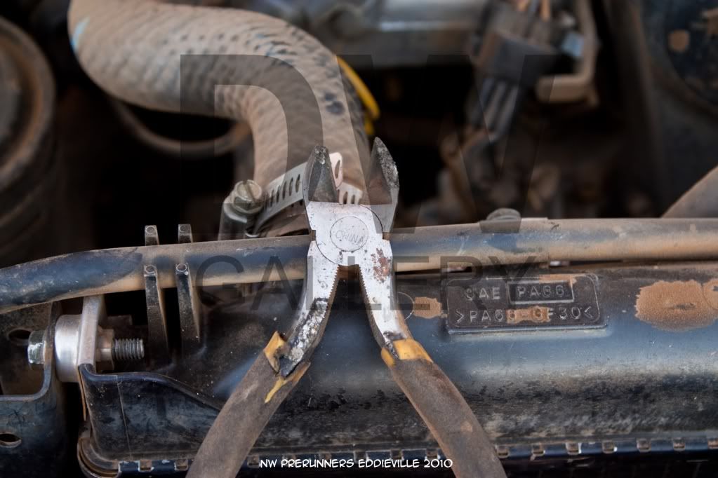

Fyi, at the first race I had a similar problem. Car would completely shut down, then come back to life a second or 2 later. Here is what I found....
They were hanging on the positive wire at the starter and rocking back and forth. The cutting end would come in contact with the main terminal on the starter and ground everything out. Might just check for a loose wire somewhere again.
BTW they were not my cutters. SABOTAGE!(still won) >:D
