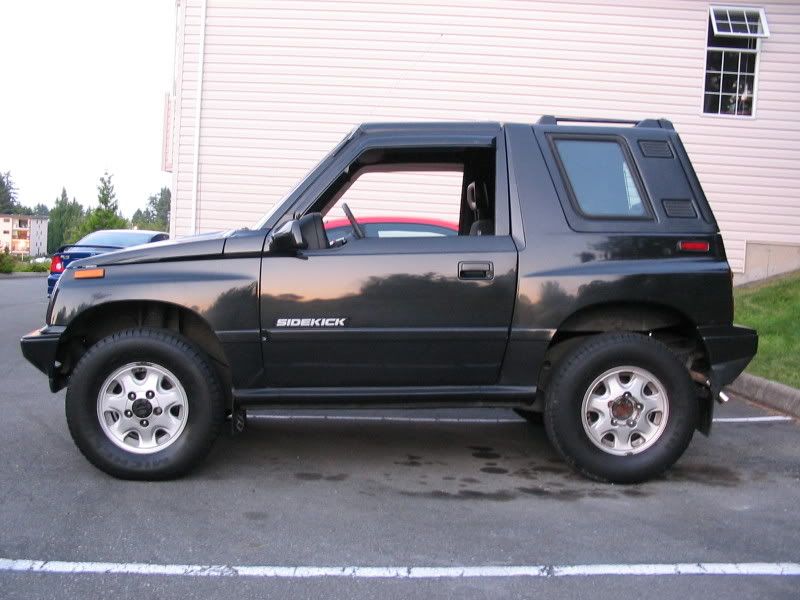

i just put in my Boondox 1.5" coil spacers to.  i got the camber bolts that they sell, so mine is pretty much normal.
here is a pic of mine, just done.  2" body lift soon to come.
sorry for the bad pic. it was getting dark, and all the others didnt turn out.

oh i forgot to mention i left the isolators out of both the front and rear.  do they make enough of a difference that i should worry about putting them back on?
4n- looks good.  how much were the camber bolts?  oh and what size are they?
