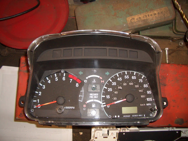

The vitara has an electronic sending unit, and there is a box from Australia that will allow you to tune the electronic signal to true the speedo for tire size changes.
I have been working on installing an electronic speedo into my 93 tracker guage cluster when I do my upgrade.  I have not found out which wires go to the contact points on the speedo yet.  I had to switch the speedo and tach positions, and have the tach wiring figured out, but still stumped on the speedo.
It still needs cleaned up a little, but this is the first try.
