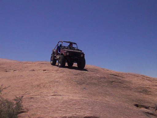

35" tires will most likely be a bit much without heavy trimming, standard tires for a SPOA is 31x10.5" tires.  I ran 33x12.5" on mine originally with some hammering to the inside of the front fender well and the rear fenders cut out quite a bit.
SJ-410 w/SPOA and 33x12.5 BFG MTR

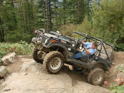

The best way that I have found to get the correct shocks was just to measure it both compressed and extended and go from there.
I am running YJ springs with an additional main leaf added and spoa...
The TT YJ kit is good for 6.5" of lift but since I have another main leaf added I would guess that I am easy pushing 7"+ of lift.
I am currently trying to wear out a set of 31" x 12.50 tires so I can go to a 33" tire but I have no plans of going any larger than a 33".
Are you running an upgraded axles ?
I don't have any experience with it, but others claim that anything larger than a 33" tire and a person should think/look to upgrade axles...
Here is my currect setup :
anytime I hear/read someone talking about mud and a Sami I think of this video (click the video pic - not the words) :
Suzuki+Samurai+showing+the+big+trucks+how+its+done
« Last Edit: September 13, 2010, 08:25:59 PM by my996duc1 »
1987 Tintop / 1.6 16V ps & ac / 6.4 t-case Twisted TT / 4.30 R&P Hybrid rear / Double Tough axles / Shrockworks all around / ARB f&r / Mighty Kong & TT full skid / DS disconnect / CV shafts f & r / YJ missing links f & r / Petroworks tintop cage / 15 gal Tank / 31" x 12.50 Pro Comps
