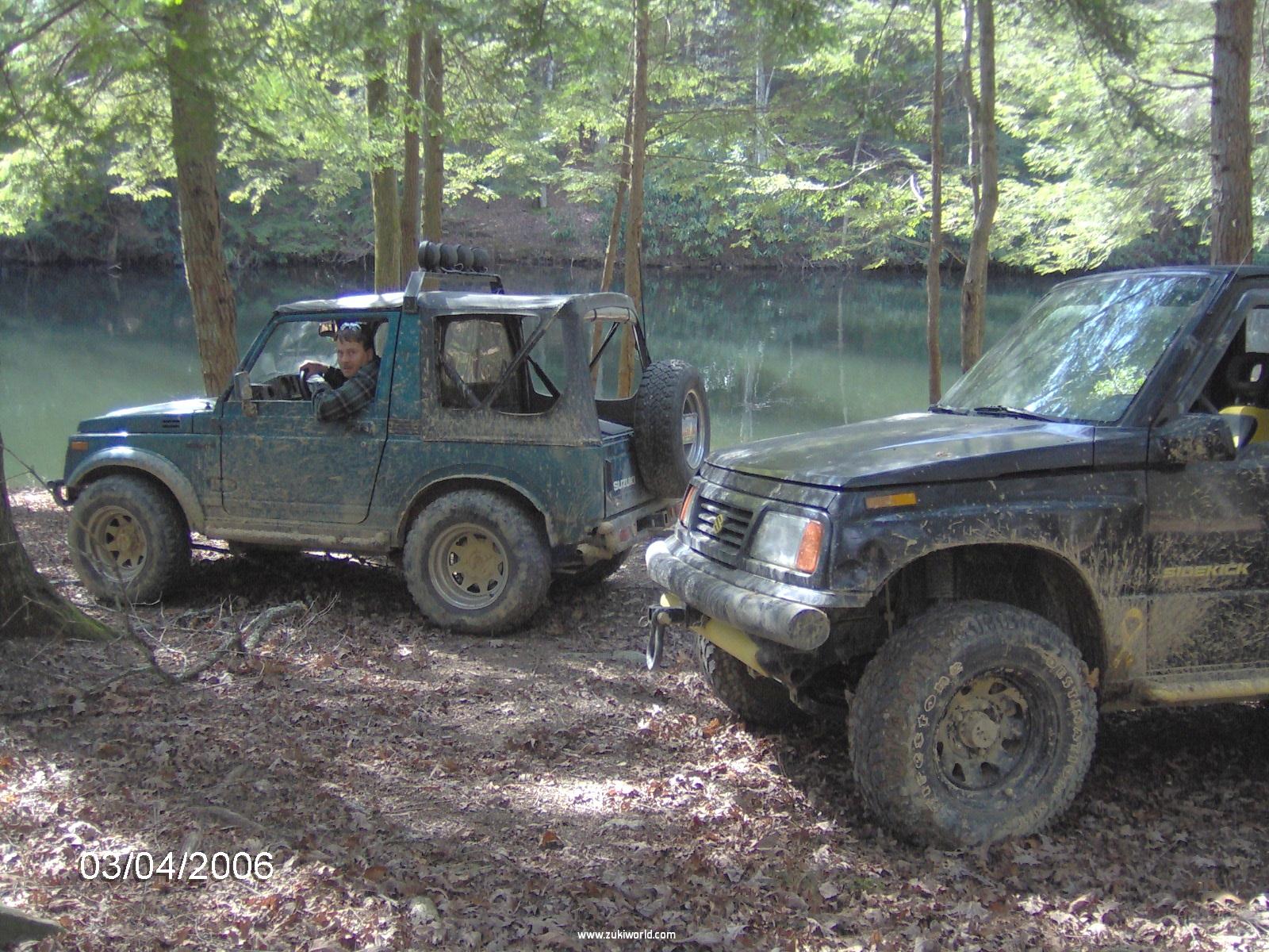

Not a great pic, but all I got access to at the moment.  235/75/15s on the Sami w no lift.  He would have rubbed the front bumper if he was still running it.  He flattened the seam that runs along the inside of the wheel well.  Tires still rubbed on the front when turning full lock, and occasionally on the rear when flexing but he ran that way for a few years I think.

I like the bumper on that kick
Thanks!  That handsome fella in the Sami made it for me!

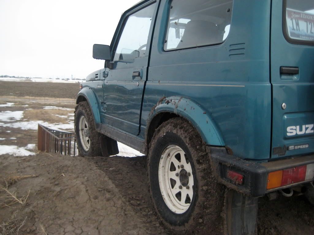

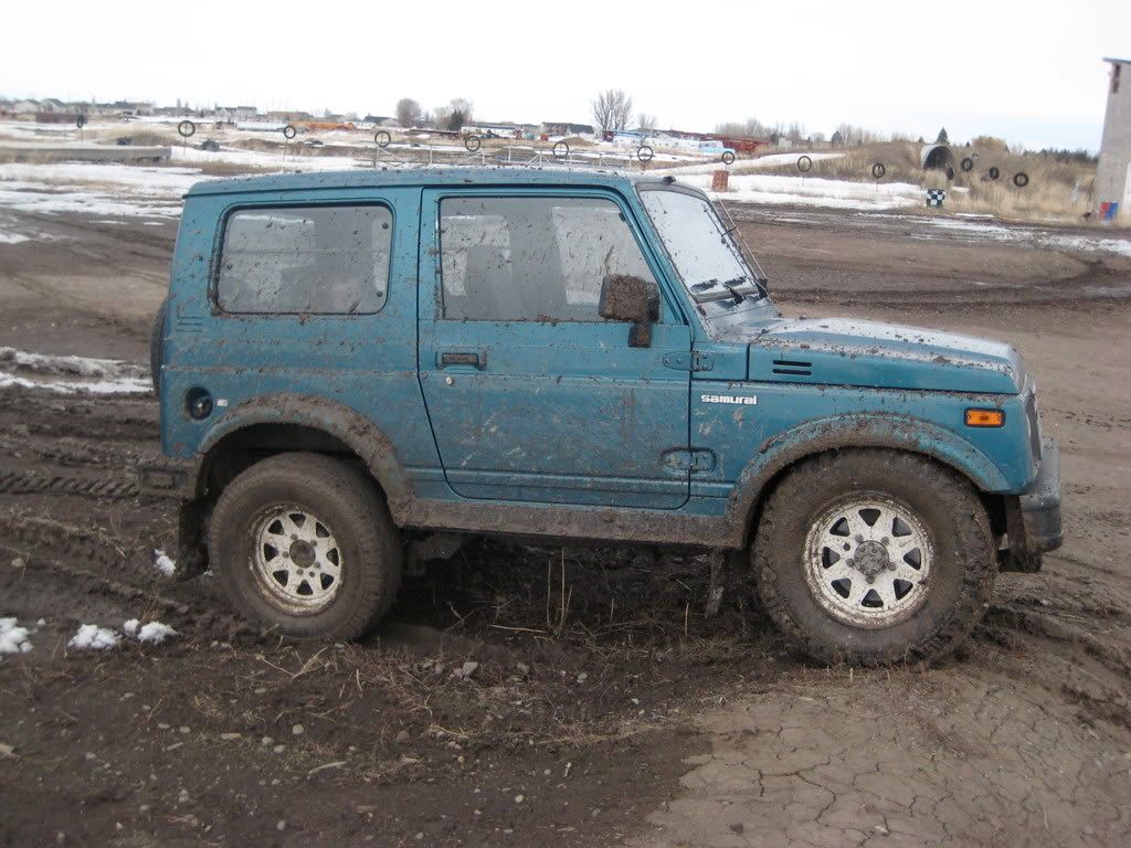

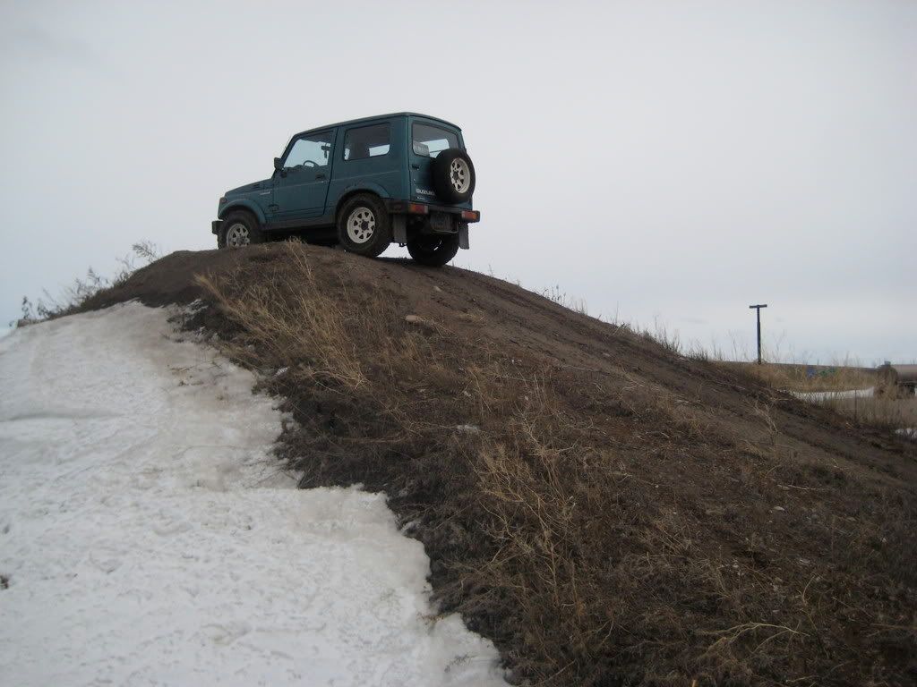

So hear are some pics of my stock Samurai now rolling on 235-75-15. I trimmed the ends of the bumper a bit and no rub. I got to excited to take pics of it clean, only after I got it muddy. Hope this helps some people.
Before tires 235/75 was sitting on 205/70

Looks good Brudha!

Looks good.  :)  Now you need to pick up some lockers!  :D

Looks good! They should have came like that stock!  Looks like you gained a little more ground clearance too.
Re: Stock Samurai with 235 75r 15
« Reply #13 on: March 09, 2009, 08:34:08 PM »
Yeah it defiantly sits higher. I took it out on the Motocross track by my house (only "trail" I can get to due to snow) and took it around most of the track and never drug the bottom. I did this with a Rhino, and it was dragging bottom and couldn't get around hardly any of the track. Not a bad rig said and done I got maybe $1100 in it right now, vehicle included in that.
