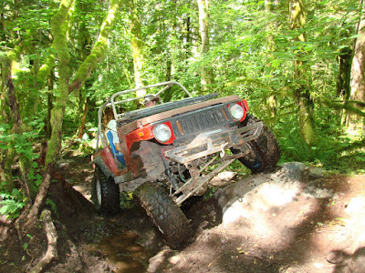

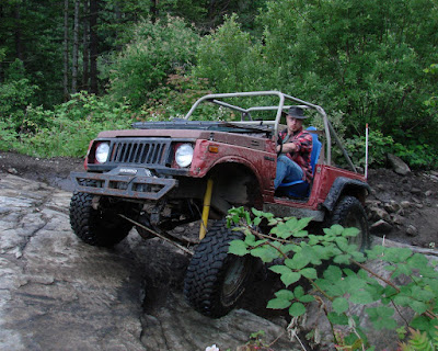

The easiest way to fix the front is to just put on new shock mounts and get longer shocks. A common swap is F-250 shock towers. But Spider Trax makes some nice ones as well.
http://picasaweb.google.com/CrawlersNW/Reiter06162007/photo#5080455461887061154
http://picasaweb.google.com/CrawlersNW/Reiter_06_30_07/photo#5085602197559254306
