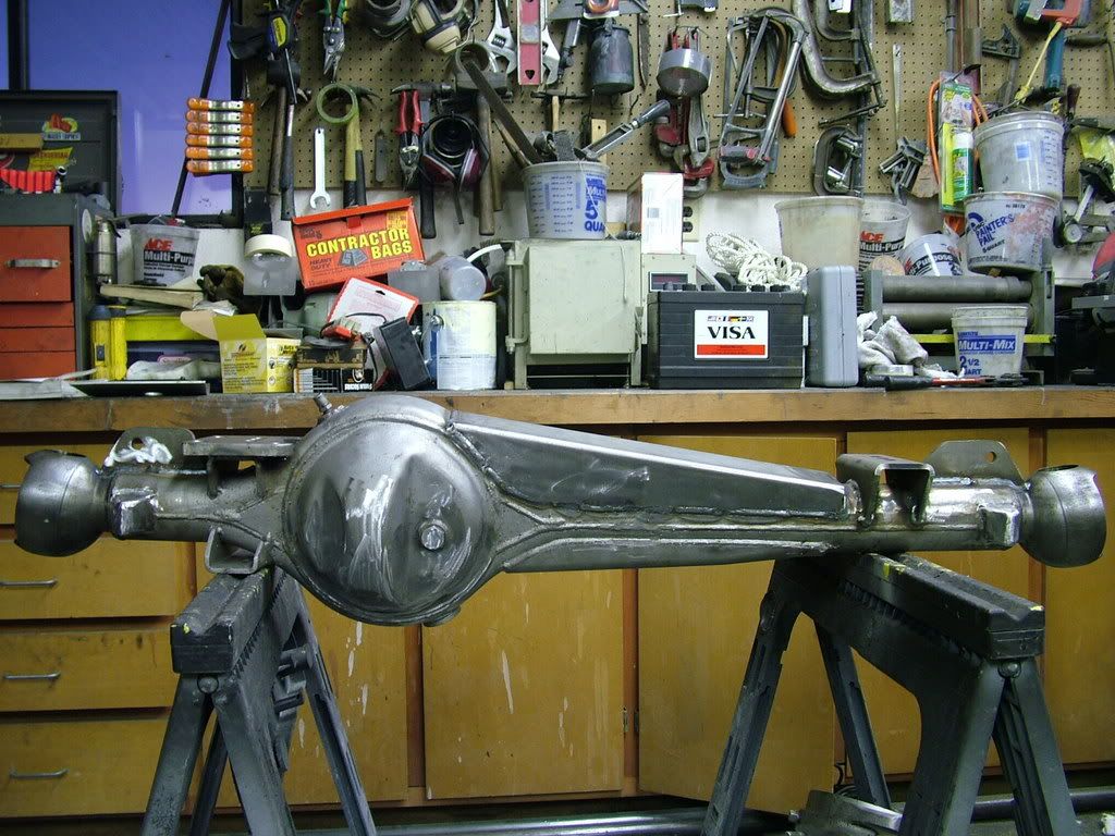

Here is my front axle with the Sky Toyota to samurai kit on it.
Here is the weld on plat that you put on the short side.

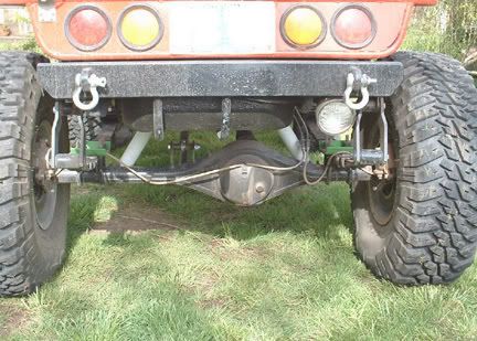

And just in case i was way off on what you wanted to see here the rear axle
I can get more pics of the front axle if you want, just let me know.

Hey Amilla thank for the picture, does your front axel is on the sammi yet?? if so can i see it??
And also what kind of leaf spring do you use, front and rear??  i know they are from a YJ, but wich year do you use and do you use the front or the rear leaf of the YJ???
Thank's alot for the pic!!!

Here's a pic of mine
Sorry for the blurry pic, i can get a better one if you want me to.
Hope this helps you out, if you got any more questions feel free to lay em on me.
