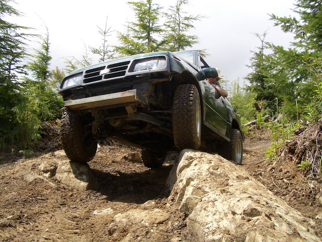

My 92 Tracker has a 2" spacer from Jeff1997 up front, 30-9.50 tires, and a locker in back.  ALSO replaced the rock panels with 2x4x1/8" rectangle tubing.  If you are going off road, these are awesome, and worth the time.
I use it daily around Skagit Valley, and trying to follow DRONE637.
