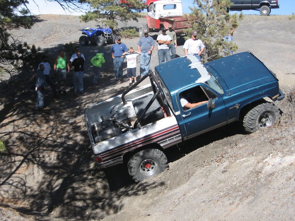

I wheeled with a Full size chevy truck a while back that was linked front and rear with tractor parts.  That thing would flex  and o yeah he roaded it there 50 miles one way!!! 8) 8)
http://i154.photobucket.com/albums/s240/mudjockey/IMG0677_096.jpg
