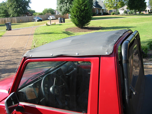

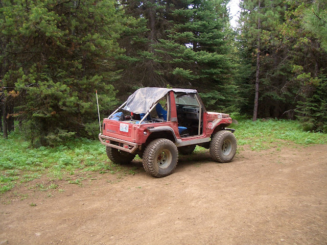

How about a safari top
Like this I made out of a old top. Just a few minutes with a razor knife
Sorry pics are old (3 years) and with a crappy cell phone

I made a similar setup, just hacked it up real quick with a knife.  Eventually I put straps on it so I could tighten it up a bit.  The fact that it comes down in the back helps keep out extra rain and traps the heat in better then a straight bikini top.

Thanks. A safari top covers the back seat as well. When a bikini just covers the front seats.
All I did is take a knife and cut the sides off. It did not flap around or anything.

Dont remember if there was a seam. I just unzipped the rear window, through it in the trash, and cut the sides off.And left the buttons on the very back that snap into the support bar that folds up and down. Took a razor knife to clean up the edges and you cant even tell it was a full soft top.
