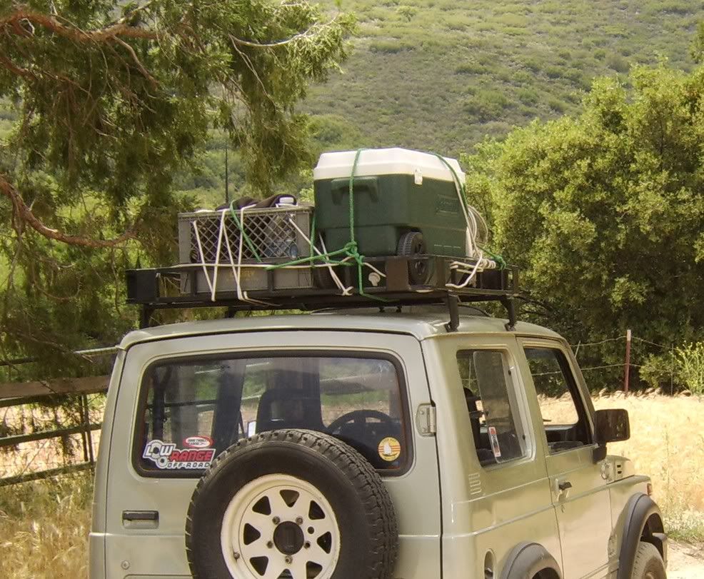

I like my roof rack. I built mine and it can hold way more weight than any hitch rack. Big plus is it will go anywhere that the Sammy will. A trailer or hitch rack will limit your access.

I can't speak for anybody else's. I wanted my rack to carry anything I could possibly want so I built it stout. I have stood on it several times (230lbs) and when my wife was collecting rock for her pond, went 4 wheeling with a milk crate full of rocks on top as well as some fire wood. And the green ice chest is my "small" one. The rack is supported by the rain gutter as well as bolted through the roof with plates on the inside. Have even 4X4'ed into some back country lakes with that canoe and all my gear including the trolling motor. Now a soft top would be a challenge but could be done. I have never seen a reciever rack that even approached looking strong enough to hold anything on a rough road. Not sold on the trailer thing either. I used one to haul firewood in from the woods and had it bounce off the hitch. And then there is the backing up thing in tight or off road situations. Now if you just want to haul it on the highway or mild dirt roads and leave it at a campround then anything will work. In that case I tow the Sammy behind the motorhome.

I kind of expected an answer like that.  230lbs is over the roof load limit for my GV, I have no doubt it's over the limit for the smaller Samurai.
The roof load limit has very little to do with the strength of the rack or how it's mounted - it's more about safety, and trying to prevent people from loading a vehicle so the weight is high up, affecting the center of gravity of the loaded vehicle, and making it more prone to a roll over.

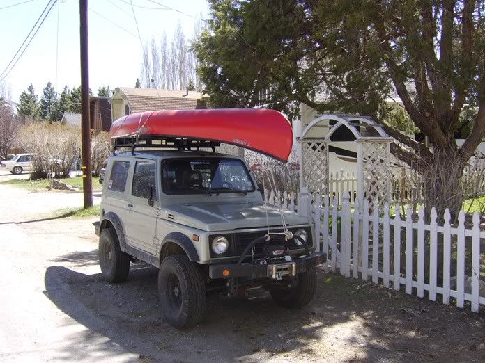

Still a nice looking Sammy & rack.  As he charted the pros and cons of building the roof rack, hitch, and trailer, I suspect he also considers the trails when overloading the roof rack.
I have been considering how to build a roof rack for my 2 door tracker to haul my pontoon boat.  I just strapped it on the top around the opening and went for it, lost paint down to metal where it rode.  Now I have a lot of hp to spare, but for normal Tracks & Sammy's a roof rack has to significantly slow forward progress, because I could feel the drag and fuel mileage really took a dive.
