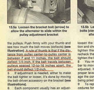

Here you go straight from the book.
Hope this helps.
