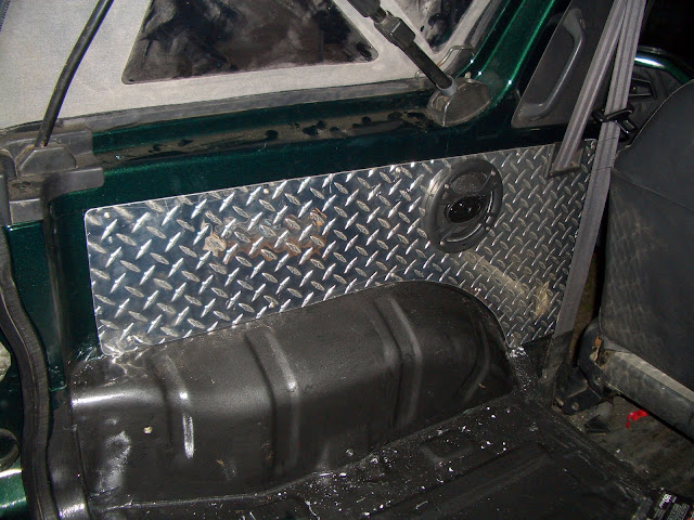

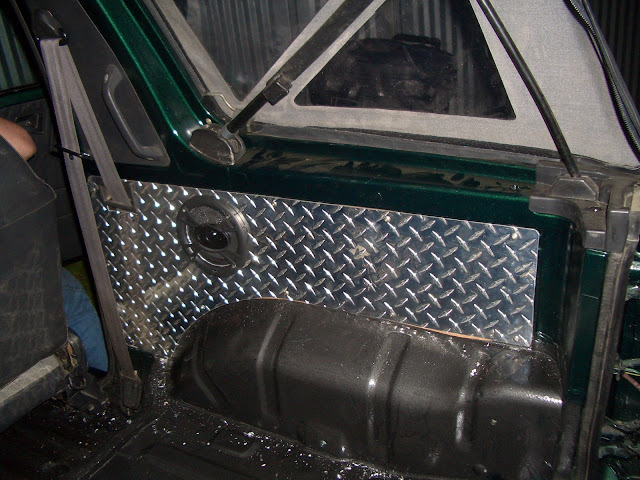

I put some 6X9 in the back panels just to the left and right of the passenger back seats.
It is a tight fit, you have to draw a pencil on the inside to get the mounting right.
I thought it would be cool to replace those cheap panels with some diamond plate cut to order.
Re: What size speakers for Samurai?
« Reply #6 on: June 19, 2009, 12:00:11 PM »
Kind of like BRD HNTR did?  :)
