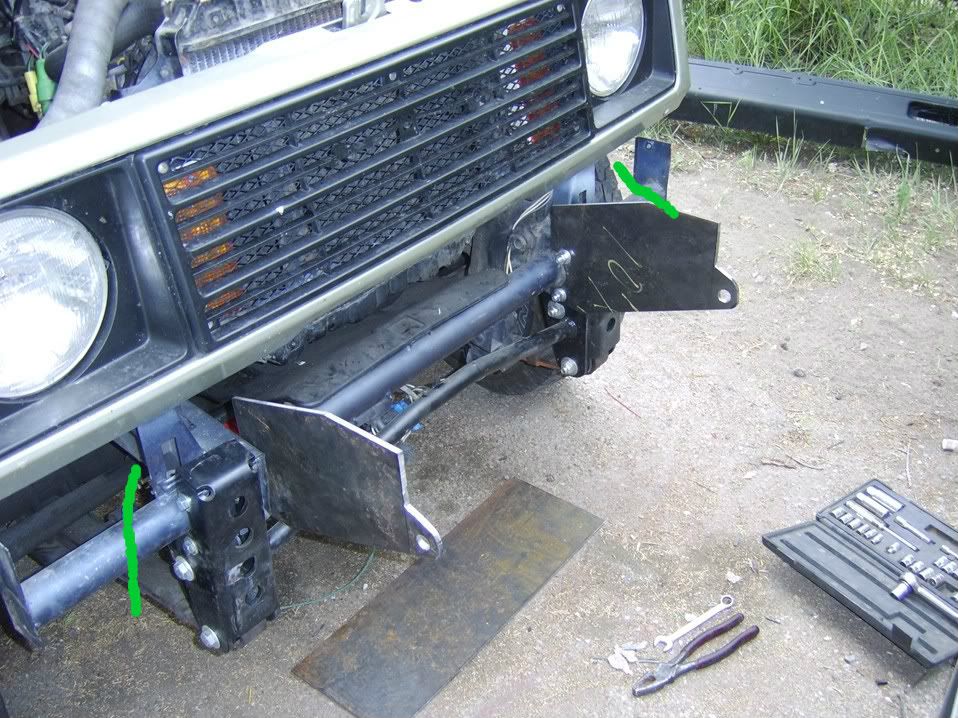

Offline tuxblacray
  • 20
    • Tuxblacray Photos
Re: Winch me!
« Reply #2 on: November 06, 2011, 06:24:16 PM »
« Last Edit: November 06, 2011, 06:27:05 PM by tuxblacray »

I'd say 6000# or better. Also make sure it's mounted securely and in as many points as you can to spread the tension. The Sammy's frame is not the thickest hence the light weight. It can and will bend or breack if too much strain is in one place. I recommend strengthening the cross tube between the frame by pounding a piece of 1 1/4" pipe in it and tacking the ends. You have to cut the stock bumper mounts off but you won't need them with a winch bumper. After I re-enforced the tube, I welded tabs from the bumper and bolted  to the tube for more strength.

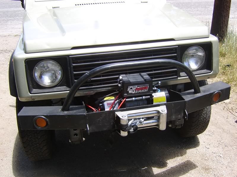

« Reply #9 on: November 09, 2011, 11:28:16 PM »
I run an old Superwinch 9000, it hasn't had an issue pulling me up anything yet.  Front bumper is spaced from the end of the frame, made with box steel:
