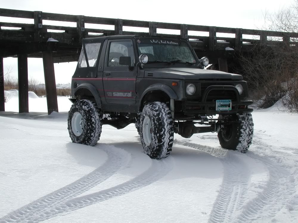

I live out in the Country so doing some test wheeling is easy for me.  I put toy axles under it and I am still working the bugs out of it.  I have a rear drive vibration from 25 mph to 35 mph I have to get rid of other than it being under powered it is doing ok yet.  I still have to do some cosmetic fixes to it yet.
I have a river flowing through my property so I took it down there and played around there for a while last week.  Here are a couple of shots.

Looks like the u bolts on your driver side front holding your front axel are loose  ???

he used round U-bolts on an 84-85 axle
Yup I have a 84-85 Toy axle and they have a truss built into them on the bottom.  They are not exactly square and not exactly round.  you can do it either way.  take square or round u-bolts and tighten them down.  They are tight, trust me.   Next chance I get I will likely put a little heat to them and form them around the axle more.
Are those 34's? I need bigger rubber  Those look about right (in prorportion to a zuki).
Those are 33x12.5x15 super swamper TSL radials.
