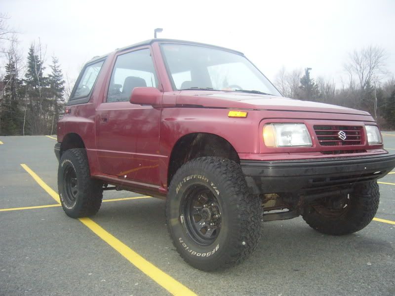

2" Suspension with coil spacers
2" Sky Manufacturing body lift - I did modify this a bit, the original blocks are 2" diameter. I read that some people had them push through the body shortly after doing the body lift. I figured this to be from the smaller surface area putting more stress on the body mount, so for the 4 center mounts I made 3.5" diameter blocks(same size as the stock rubber cusion)
If I were to do it again(and actually will be soon to fit 33's), I'd just make a 3" box tube body lift.

thank you!  that is what I was looking for.  Do you think I will have any problems with rocky road's lift pushing through the floor?  Now you got me scared!

Well, RRO's body lift is the same. I think it all depends on where you live, I'm right on the ocean in the north east where the fog gets thick at night, and in the winter there is salt spread on the roads. Rust free body's are not common. I'd just check the mounts over before you turn away from doing it. The ones that are really bad are the two in front of the rear tires.  It's just metal, it can be fixed ;)
