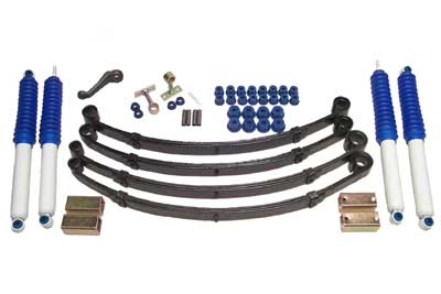

Found this while surfing the web.
I have heard from some that they would love to stay spring under so I was wondering if this kit really looks complete.
No extended brake lines.... no driveshaft spacers..... but is says complete 4" lift Spring under lift.
http://www.4wd.com/newsite/shop/productdetail.asp?pid=493209&model=import

As far as that kit is concerned I'm not too sure they took pictures of the correct parts the springs look too flat and they have four front style shocks in the picture.
4wd picture 4 inch lift
calmini picture 3 inch lift

The discription does NOT say it's complete - in fact, it say's you'll need to buy something to correct the steering issues.
I would avoid that kit. Looks like the springs are "re-labeled" in other words - they're probably cheap springs with someone else's name on them.
Get the YJ kit from Sky or Rockey Road Outfitters.
