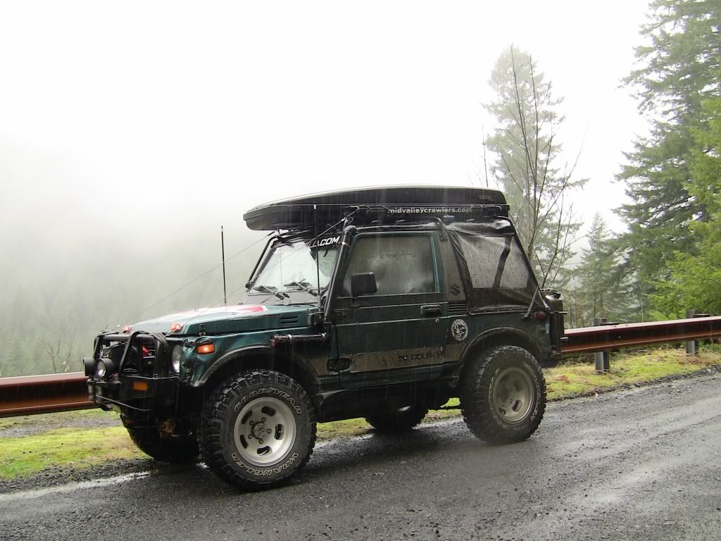

Oh, and here's a recent picture of the old girl:  (Hope you enjoy the threads I linked)
