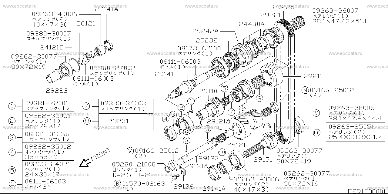

After more data collection this is what "I" have found out.....a parts diagram I dug up online w/ suzuki part numbers:
The suzuki number (that I need) shown is # 09263-40006
The bearing measures: 40x47x30mm   (shaft x OD x depth)
I dug up some chinese company named NBB-bearing that makes this size, part # HK4030. But unfortunately I cant find a distributor and my local bearing shop didn't have any listing/cross reference in what they carried to match this size. SO I broke down and called trail tough and they had a new one on the shelf for ~ $37, which is fair. Now lets hope I see it by the weekend.
