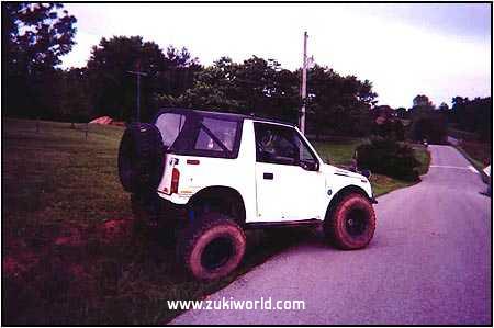

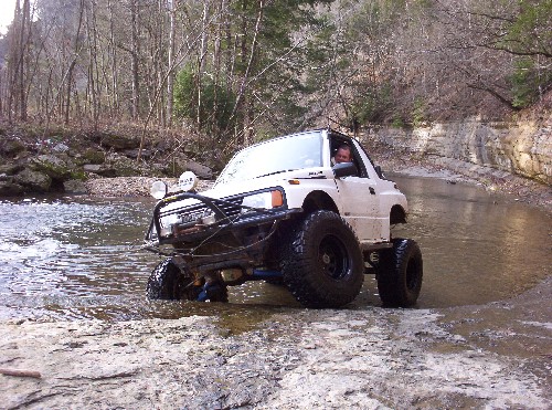

It really depends on what all you do to it.... Straight from Calmini, the front tracel is slightly increased while the rear is increased by a few inches (if I remember correctly). With a few tweaks, you can get more out of the front and rear travel. Look in the article archives under Hagen Sport for : 1- front end widening, 2- rear axle over rotation and the rest of his articles for some good info.
Calmini 3+3 lift, no tweaks (full flex):
Calmini 3+3, OME Struts, front end widening, rear axle over rotation+longer rear shocks (not at full flex):
If you tweak the front any beyond what Calmini designed, pay close attention to CV angles and lengths. You can easily go to far and make it where you destroy CV's every time you go out....
