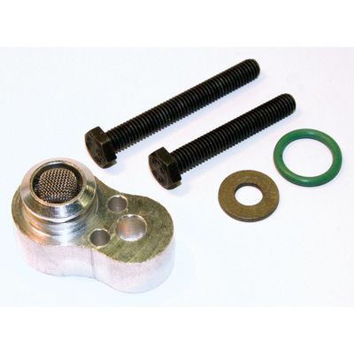

I bought a new one from Performance Radiator installed it along with another expansion valve and receiver/drier. The filter I installed helped big time, it caught A LOT of shavings/trash. I also bought some universal inline filters that go inside the lines. Suction screens. I installed 1 on the inlet and 1 on the outlet of the compressor to keep this new one safe. These are the 2 I bought. 5 GM A/C SUCTION SCREENS, KENT MOORE J-44551-80 0.500" 12.70mm | eBay
5 GM A/C SUCTION SCREENS, KENT MOORE J-44551-150 0.600" 15.24mm | eBay
Flushed it all again and recharged.
This time we made some small progress, it lasted for 2 days but it worked half capacity and cold then warm. Opened up the filters and they were bad. The first inline filter I bought was so clogged up I had to throw away the screen. Good thing the other screens fit in that body. Flushed it all again and new expansion valve and new receiver/drier.

I don't have picture of the suction screens installed but here is a general picture.
