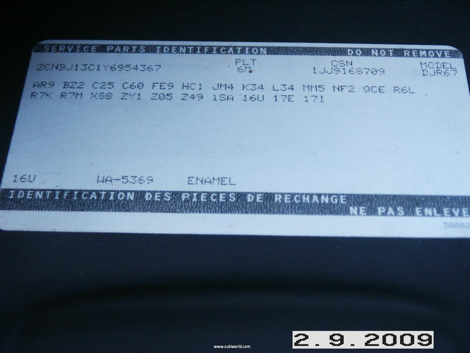

I have a 2000 Tracker made at the CAMI plant with the 2.0 and 5 speed.  Based on the calculations I have conducted with a gear and speed application that I have, I think I have the 4.875 ratio.  100 kmh is just short of 3000 rpm.  If I had the 4.62 ratio I would be going about 107.  Tires are stock 205/75R15 - 27" tall.  Is there a speedo error?  Don't know.  However.
According to the 2000 service manual at page 0-10 there should be a service parts identification label somewhere in the instrument panel compartment that will confirm the various codes.  Axle ratios are HC1=4.62, HC3=5.12 and HC8=4.87.  Trans ratios are MM5, manual - no ratios listed, M41 auto and M59 manual which I think is for the 1.6 given the note of .795 for 5th gear , 2.0 has a .777 5th.
Anyone know exactly where the label is?  Wouldn't mind knowing but I don't what to haul the whole dash apart either.

After cleaning the junk out of the glove box there was the service parts id label with all the build codes right on the bottom of the glove box.  I knew I had seen it before.
My 2000 2.0 5 speed Tracker does indeed have the 4.62 axle with code HC1 and the MM5 trans.
I suspect all the CAMI built vehicles have the label in the same place.
Here is what mine looks like:
