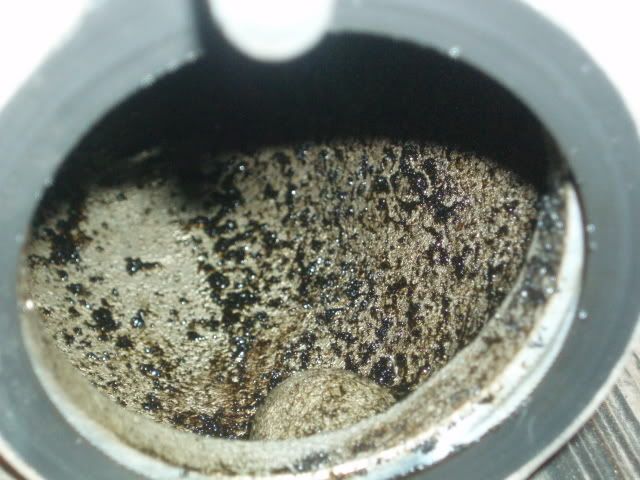

I am in the process of replacing the pod-type air filter, that has been on my V6 since I bought it, with a cyclonic action filter housing from a 60 series Land Cruiser. I had to take off the black plastic duct running from the throttle body to the air filter to modify it, and to get that out I had to take off the balance pipe that connects the fronts of the plenum chambers for each bank of cylinders.
When I took the balance pipe off I noticed that the inside of the intake was covered in oil and gritty black carbon deposits  :o
The oil is no concern as it comes from the crankcase breather which is plumbed into the intake. But the black crap has me worried. From what I can figure it is probably getting in from the exhaust through the EGR valve. I hate think what effect it is having on the valves seating properly and what wear it is causing to my lovely smooth cylinder walls :(
Here is a photo looking into one of the plenum chambers with the balance pipe off.
Has anyone seen this on their GV or any other EGR equipped vehicle?
Please discuss.

Thats carbon man. Get a bottle of intake cleaner and a rag made of actual MATERIAL and spray the rag and put it in the intake and put a screw driver in the center of it and rub the walls.
Then after spray the sides just a bit and put it back together.
Now this is a 2.5?? If so start the truck up with the black in take tube off and rev the motor to 1500 rpm and spray the throtle body but go past the Mas Air and do this for a few seconds and let truck idle do again a few times and this will clean the intake and valves out.
Make sure u do a oil change after u do this.

Comon problem in cold climates.
My EGR is doing the same thing now on my GV its sizeing closed I could careless but possible cleaning it could help they carbon up most egrs dont work tell mid rpms.
My CEL comes on every few times now due to the EGR valve.
Try cleaning it.
