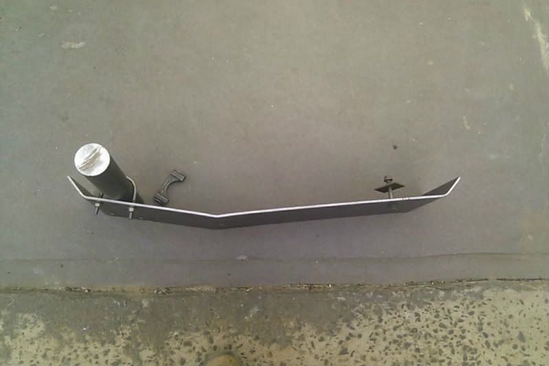

Been having similar troubles down here with the cross member. Bet the thing badly doing some rocky tracks. Notice the slight banana curve in it....not good.
The design ive settled on is a bolt on skid plate that bolts through the gearbox cross member and clamps to the tube chasis brace.  Its very simple and quite effective.  All it requires is a hole drilled through top of cross member.
here is the un-finished prototype....
That is very similar to what I use on my Tracker.  I have mine bent up on sides for strength, and welded it into the center section.  Still use the bolt through.
I have bowed my 3/16" pans sliding over some very solid rocks.

I'm building mine out of the two wing extensions off of an old FJ60 winch bumper.  They are very heavy as well, at least 3/16" if not 1/4" channeled and the ends are curved slightly which would facilitate sliding over crap versus digging in.  I like your idea for posting to the rear cross over.
Initially I was just going to weld an extension plate up to the crossmember and sandwich it to the crossover with a suitable muffler clamp.  Your skid has given me another "more better" idea for it.  Thanks much.
