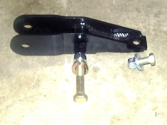

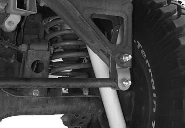

« Reply #11 on: February 21, 2006, 10:07:20 AM »
here are some pics of the bracket I would want to make instead of using calmini's bracket. It's made for a 4 runner but I looked and it's possible for me to make pretty much the same thing and bolt it right on

Why not just put a longer bar in?

« Reply #13 on: February 24, 2006, 11:11:19 AM »
Cause u would start changing suspension geopmetry and when u start hitting big bumps going straight ur rear end would want to push out to the left  :-[ scray shit lol

« Reply #14 on: February 24, 2006, 05:39:48 PM »
I kind of want to do a combonation of the drop bracket and longer bar. I want to make a bar with hiem joints on both ends that is adjustable on the passenger side. as far as going sideways, it already does, that's what I hate about 5 link. don't notice it from the driver's seat though, if I go too long on the bar I do see how it could actually be a serious issue, I guess I'll have to find a sweet spot
