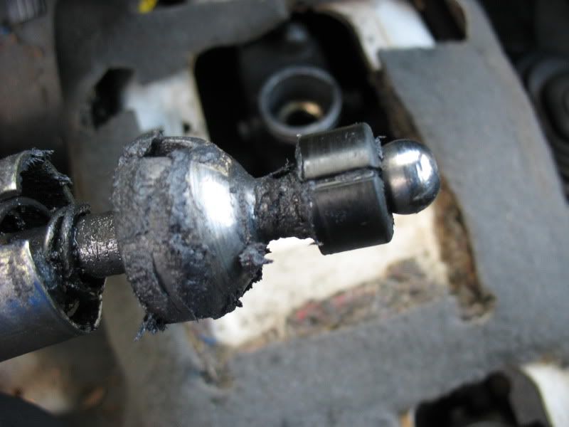

You can see in this picture that the cup for the shifters end ball had been forced over the end ball because the shift sheet and retaining collar were shot. Tons of slop when I bought my Sidekick, but knew the "G"string would cure that problem and now really enjoy the shifter feel.
Just something to check and may help your shifter.

Hrmmm, definitely don't want a LONGER shifter.  Loved how my Ranger required quick, short throws to change gears.  The Miata was similar.  My buddy's Hurst setup in his TJ is also similar.  Right now, to me, it feels like shifting gears takes too long between the gears.  Also if you don't have it perfectly lined up it may not work correctly and that's not awesome. :(
Where exactly does the shifter sheet go in that picture?

The shifter sheet replacement, the "G"string, is installed in that picture, you can just make out the yellowish ring colored thing in the shifter tower it is what the big ball portion of the shifter sits and rides in-on.
