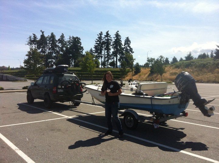

I originally bought it so i could tow mine and my girlfriends dirt bikes. With a small two railed trailer the little 4 banger never skipped a beat. Now the dirt bikes are gone and we tow around our boat. I estimated the boat and trailer to be around 1000lbs but with enough time and patience the Vitara does just fine.
