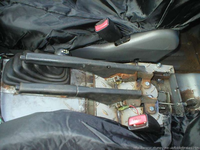

Some of the old volkswagon beetles had a similer system. We called them cutting brakes. Backhoes have the same system with two brake peddles one for each back wheel. The peddels are pinned together but can be unpinned if needed for individual control.

I have seen it done on a GV on another forum. Unfortunately the website of the build-up doesn't exist any more.
There are separate cables from each rear wheel coming up to the underside of the handbrake lever, with a pivoting plate connecting the two to the lever. All it takes is a bit of fabrication to mount a second lever and hook up the cables separately.
If you take the carpet out of the back you can see both cables running seperatly.  They go through the floor right behind the middle console.  It wouldn't be too hard to get a second e-brake handle and hook one up to each cable...like a cheap man's locker..one side starts to spin freely, so you apply the brake.

« Reply #7 on: May 05, 2010, 10:24:54 PM »
Here's a pic for ya.
