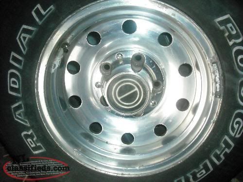

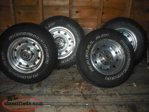

I found a set of rims of a 95 F150 for sale but they are a hour and half away from me. I was wondering if any one has tried mounting these rims to there tracker before?

one of my friend have some similar rim that was from a f150 if you can remove the middle it supose to have the same hole that the tracker one he says that they suppose to fit .

I've read on here before that it depends on the brakes your rig is equipped with.  My Vitara came factory with 16" wheels, and a 15" wheel won't fit over the caliper.  It seems a lot of the Trackers came with 15" wheels though, so from what I've read, it they should probably fit.

yeah i buy a set of rim that was not fiting first so i grind a part of the brake caliper just enough to put them round now they fit never touch the brake and its a mecanic that told me to do that .
