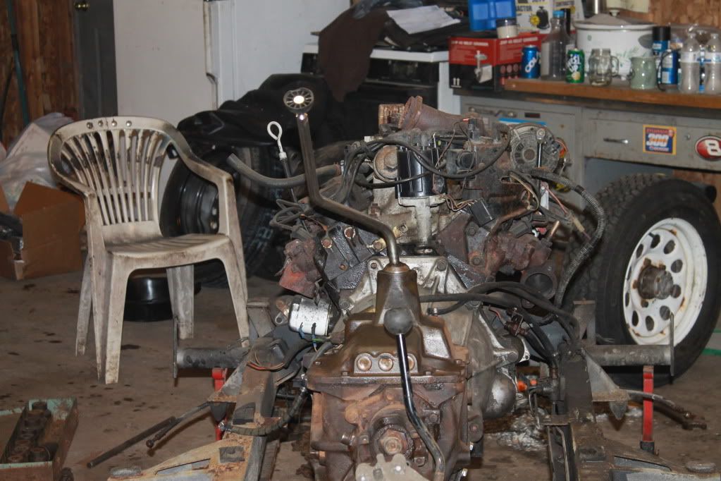

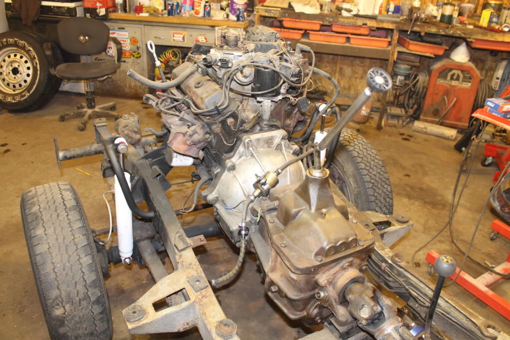

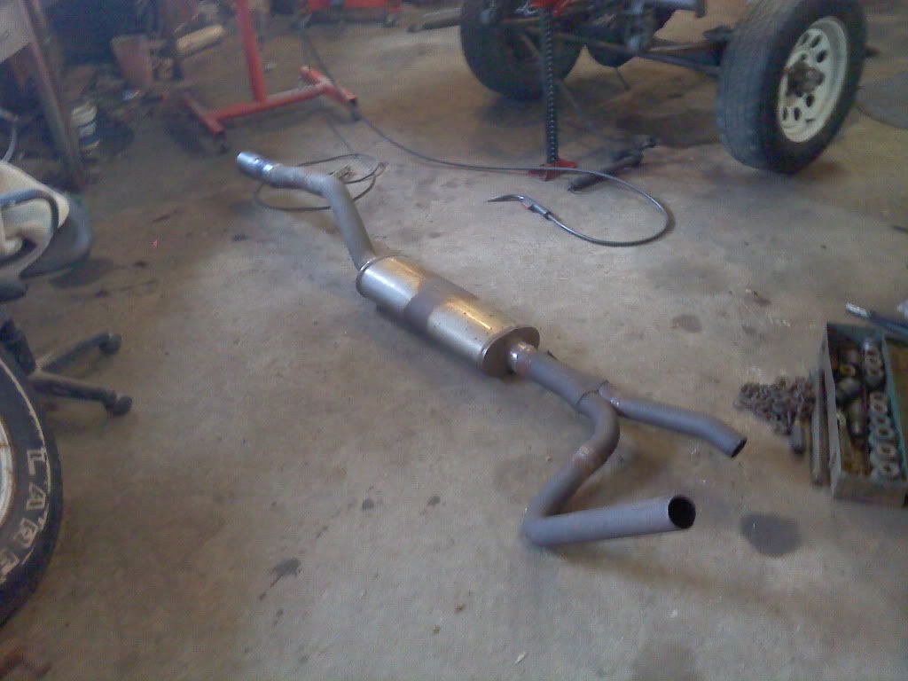

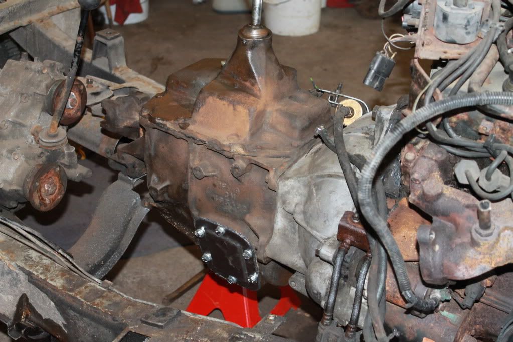

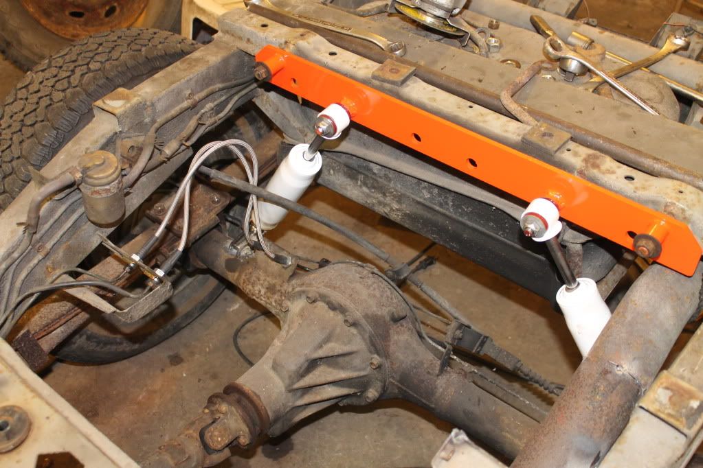

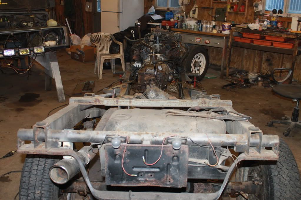

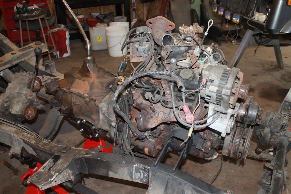

Hey all its been a fun few weeks making a almost solid sammy with a 1.3l that had some seperation issues run again! so far what i have done to it is drop in a 89 2.8 v6 with roughly 70k on it mated it to a 82 sm465 out of a 1.5 ton dump mad my own custom lttle cv shaft, re wired it so the efi would be functional and threw on a low range off road weld on spoa custom fabbed up a full jba exhaust of a nissan titan. all thats left is to make a new trans tunnel and a few minor things.. but i took it out for its first spin and got it stuck.... lol well on to some pictures i need to get a few mor up to date ones yet.....

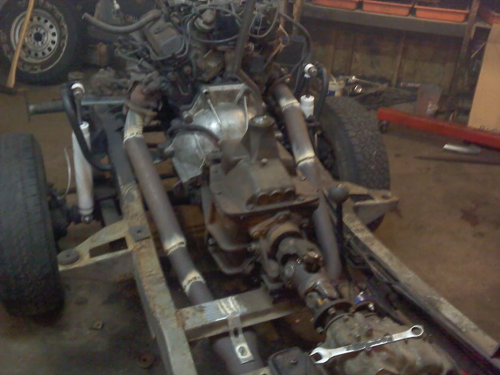

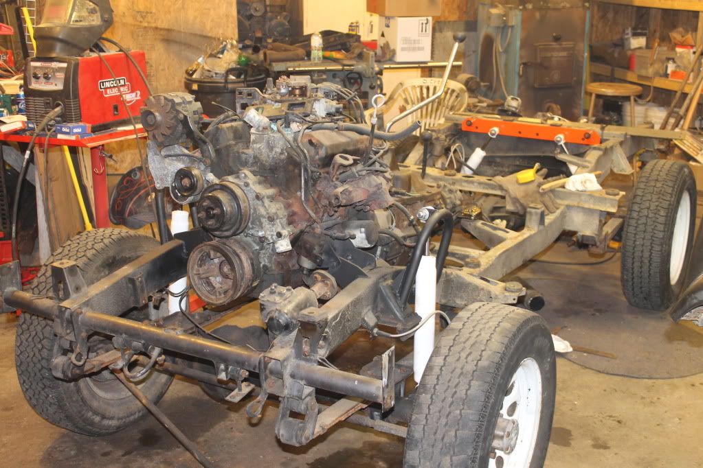

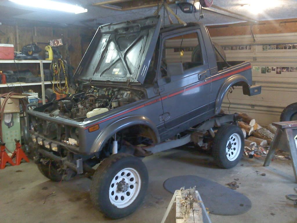

before

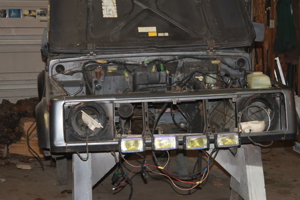

after
other randoms body going on and 3" jba exhaust i got off a titan at work.....
