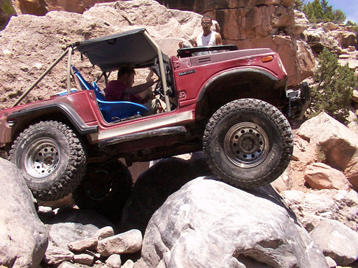

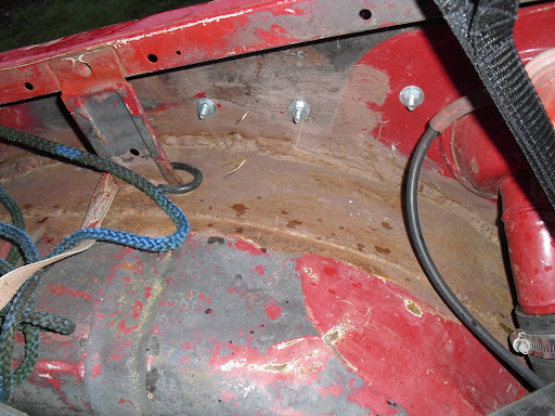

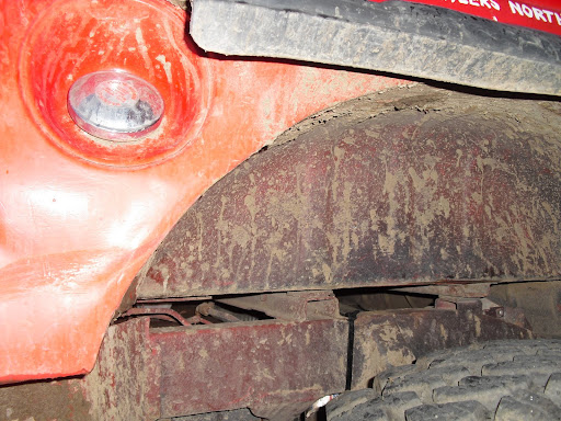

I cut out the fender where it starts to slope down and put in a new chunk of metal.  It also gave me another 2" or so of clearance for the tires.  It allowed me to clear 33" tires without an issue with a standard SPOA.
And an old SJ-410 with SPOA shot from 6+ years ago:
