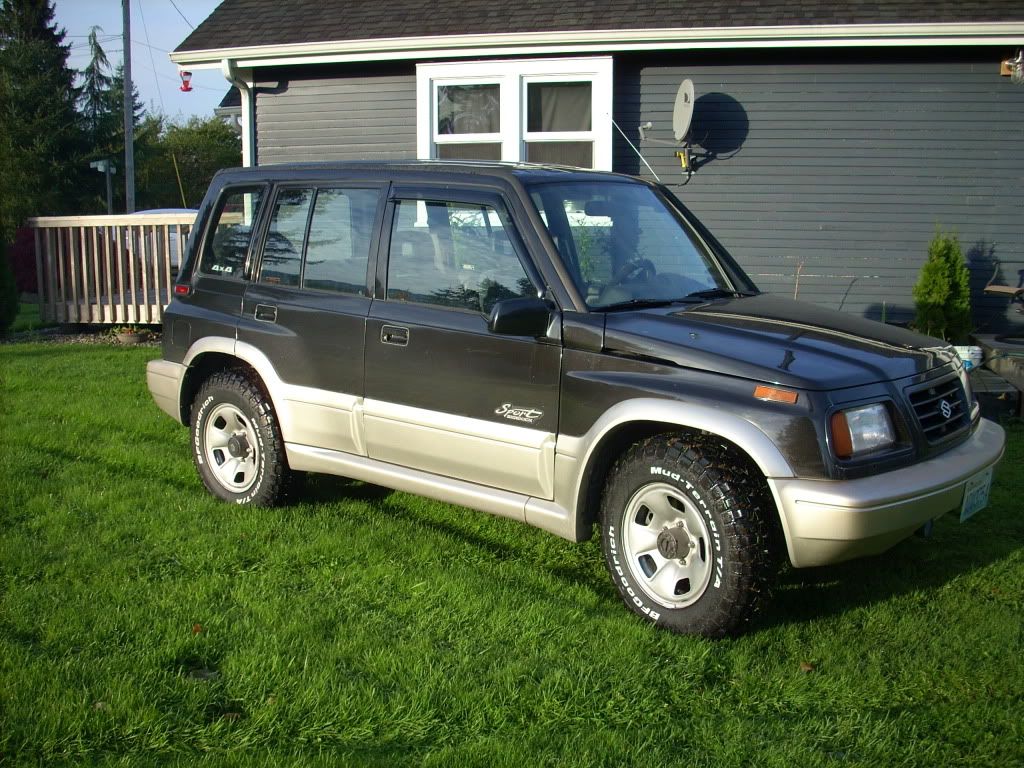

Got my new tires today, here are a few pictures.
This is stock 215/65/16 tires, next to my jeep.

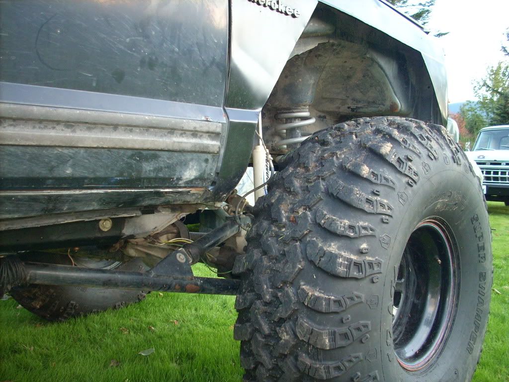

This is my jeep, 8 inch long arm lift on new 40inch swampers. This thing crawled all over Reiter Pit trails, about 5 mins away from my house. Since they closed Reiter down, I lost interest in finishing this project .
Allot of work still needs to be done to this thing. Hopefully I will be selling it this weekend if the potential buyers show up.

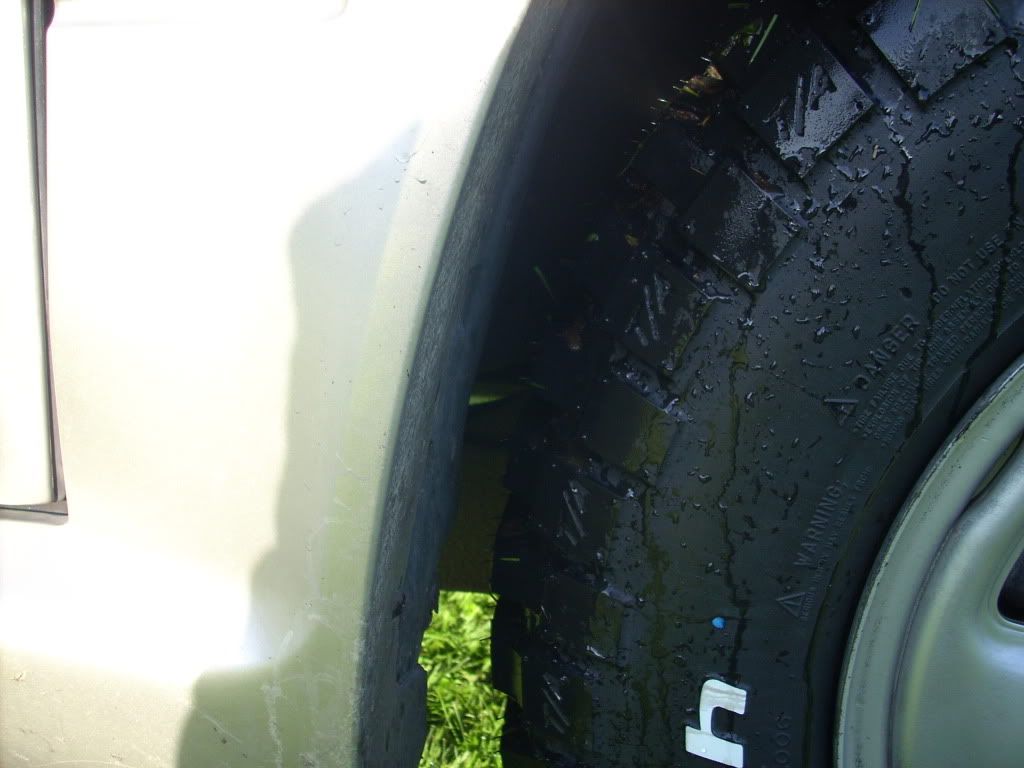

 My 96 Sidekick sport (stock height) on new 225/75/16 BFG KM2's
Looks like a 2 inch  suspension lift will be perfect. The tires don't rub but it is close, when fully flexed it will probably rub.

Looks like you WILL have some rubbing issues.

Yep, I got the rear tires to rub when stuffed yesterday :)
 Going to order up a 2inch lift as soon as I save up some money.

I am still running stock height and it does rub when flexing, mostly in the back, by the rear doors.
I am still waiting for my 2 inch lift to come. When I get the lift installed I will see if the rear tires still rub. If they do I will just move the rear axle back about 3/4 or one inch, it should fix my problems.
