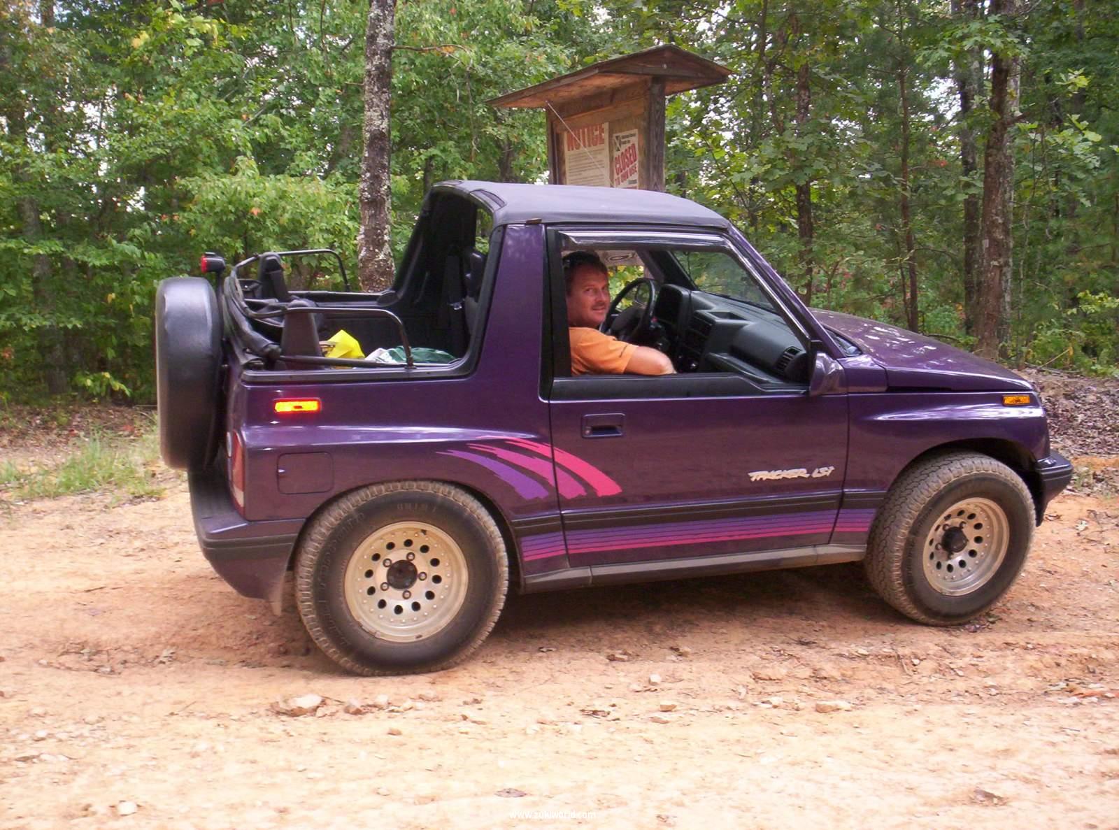

best i can get of when i had 235's with no lift.
thats maybe a week after getting them installed, tire shop said they wouldnt fit and would rub, i had to tell them to just do it. they only rub the frame SLIGHTLY on full turn. i just swapped them over to another sidekick and it only rubs when turning to the right full lock. just need to adjust the steering stop a bit.
thats the best picture i have of it at a straight side angle
31" kumhos 3inchs of lift.

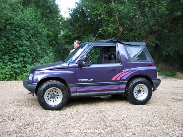

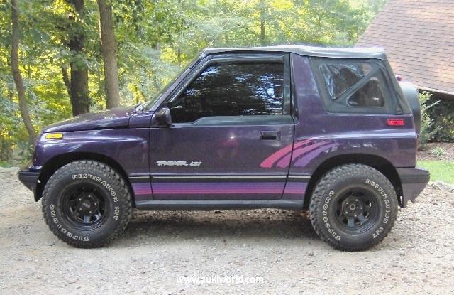

None of these are stock wheels, but both are 235 75 15 tires on a stock 95 Tracker.  The MT tires rubbed too much, mainly in the back of the front wheel well.  The other tires, I ran on it as my daily driver up until recently but they rubbed too much to wheel much with.  Rub a little on the front when turned full lock and rub in the top of the back wheel wells.  Probably could bend the lip down on the inside of the wheel well to help there.  I would think the narrower stock wheels would help too.

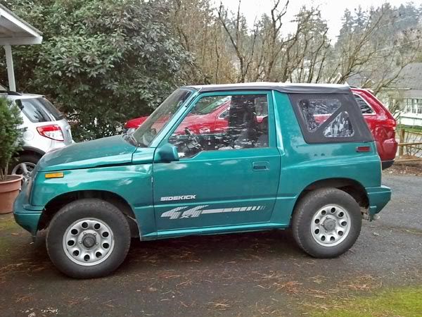

Some thread necromancy because it's relevant. :P
My mostly stock 'kick after doing some rally style driving in SW British Columbia. Tires are 235 Goodyear Wrangler Territories, noisy but awesome skins with only a wee bit of rub on the frame w/o adj. My buddies JDM Jimney is taking a Guinness break.
