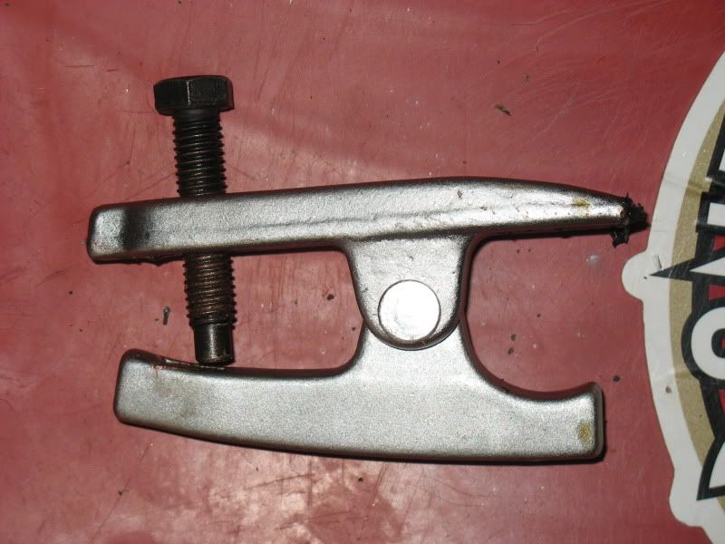

I fully agree with bentparts, the center link is usually ignored.
I have several pickle forks and do not use them at all, I use this tool to seperate tapered joints, and it has never failed to work properly and with minimal effort.
Check out your idler arm and mount, large tires will weaken them quickly, a SKY idler arm is a easy upgrade
Also, most people simply assemble taper joints and some even clean them to remove any grease/oil/protectant, I ALWAYS douche down both potions of the taper joint with a corrosion preventative/water displacement like corrosionX or WD40. This will prevent ANY FUTURE corrosion from developing and allow easy as pie disassembly at any future point.

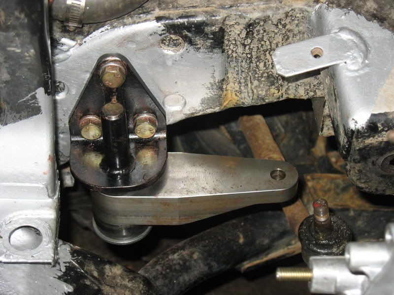

We have started adding a brace to the bottom of the idler arm to stop it from flexing, which is what usually leads to the bending:
