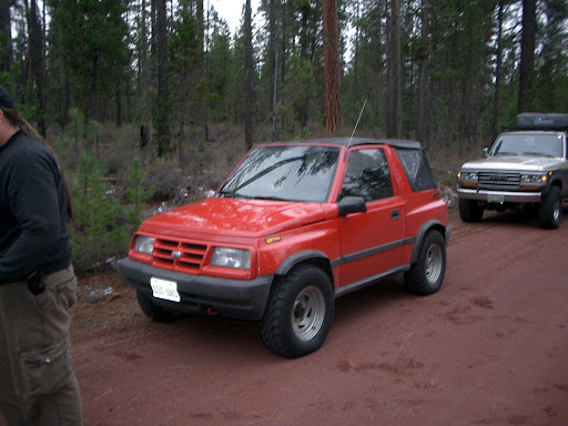

235/75 R15 MTR's will fit on with no trimming as long as you don't use an offset rim or wheel spacers:

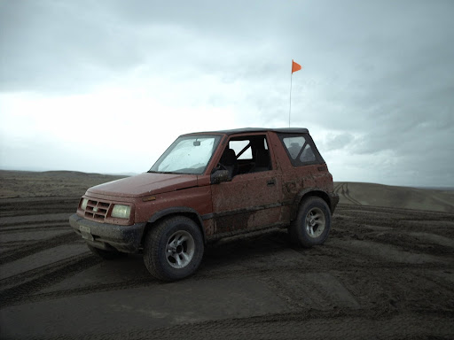

With offset wheel spacers you will get rubbing.  A 1" spacer in the rear and 3/4" spacer in the front is enough to solve that issue.  Some light front bumper trimming was required:

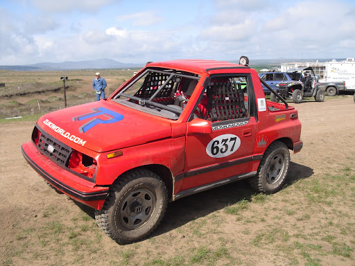

With the right set of tires you can squeeze a set of 30x9.5" tires onto a 2 door with 4 door front springs and some bumper trimming.  The front tires do rub on the top of the fenders on full compression and the steering bump-stops were adjusted to stop rubbing against the frame:

I love the baja one, is pretty much stock suspension or did you beef it up somehow?
We added some bracing, but that is it.  You can see the build thread over at http://www.zukiworld.com/forum/build-diaries-how-to-diy/project-trouble/
