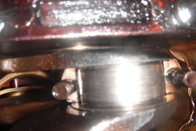

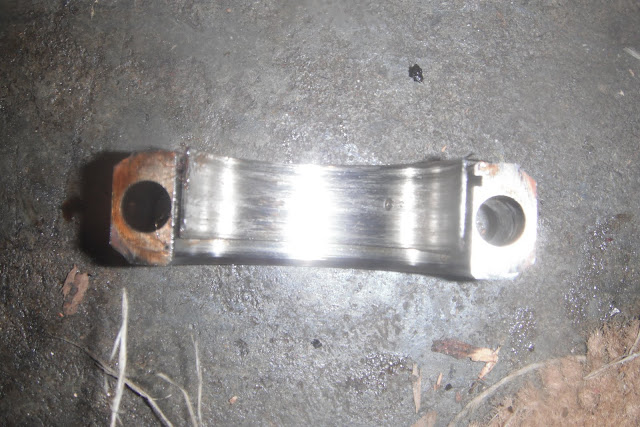

This motor does have a small knock on bottom end.  I pulled the pan (should have stopped there), oil pickup was half fouled.
The short story is #4 rod is spun, rest look very good.
I am not going to pull the bottom off it to check mains as at this point it does not matter, and I want to keep it somewhat intact.

Looks like lack of oil changes huh?
